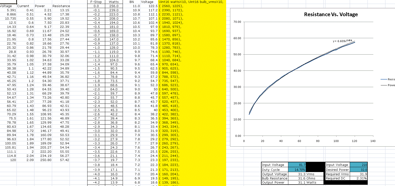

Recently, I did a project in which I needed to be able to control the power to a 250w 110vAC bulb. My first assumption was that the bulb resistance was relatively constant and would introduce little error across the 110v range. I quickly learned that the assumption was WAAAY wrong. So I made a table in Excel and filled it in with various voltage and current measurements.
For instance:
0.41A @ 5.39v
0.51A @ 8.67v
0.55A @ 10.74v
0.93A @ 28.8v
1.20A @ 45.25v
1.55A @ 70.29v
2.09A @ 120v
I took over 30 measurements to build my table, that was just a few of them.
I was then able to calculate power (V * I) and resistance (I / V / V)
I then graphed Voltage vs Resistance and saw that it made a VERY nice curve
For the bulb I used, bulb resistance = 6.61 * voltage^0.454
Based on that information, you can calculate power vs. RMS voltage of a bulb. You just have to take the time to figure out the relationship.
