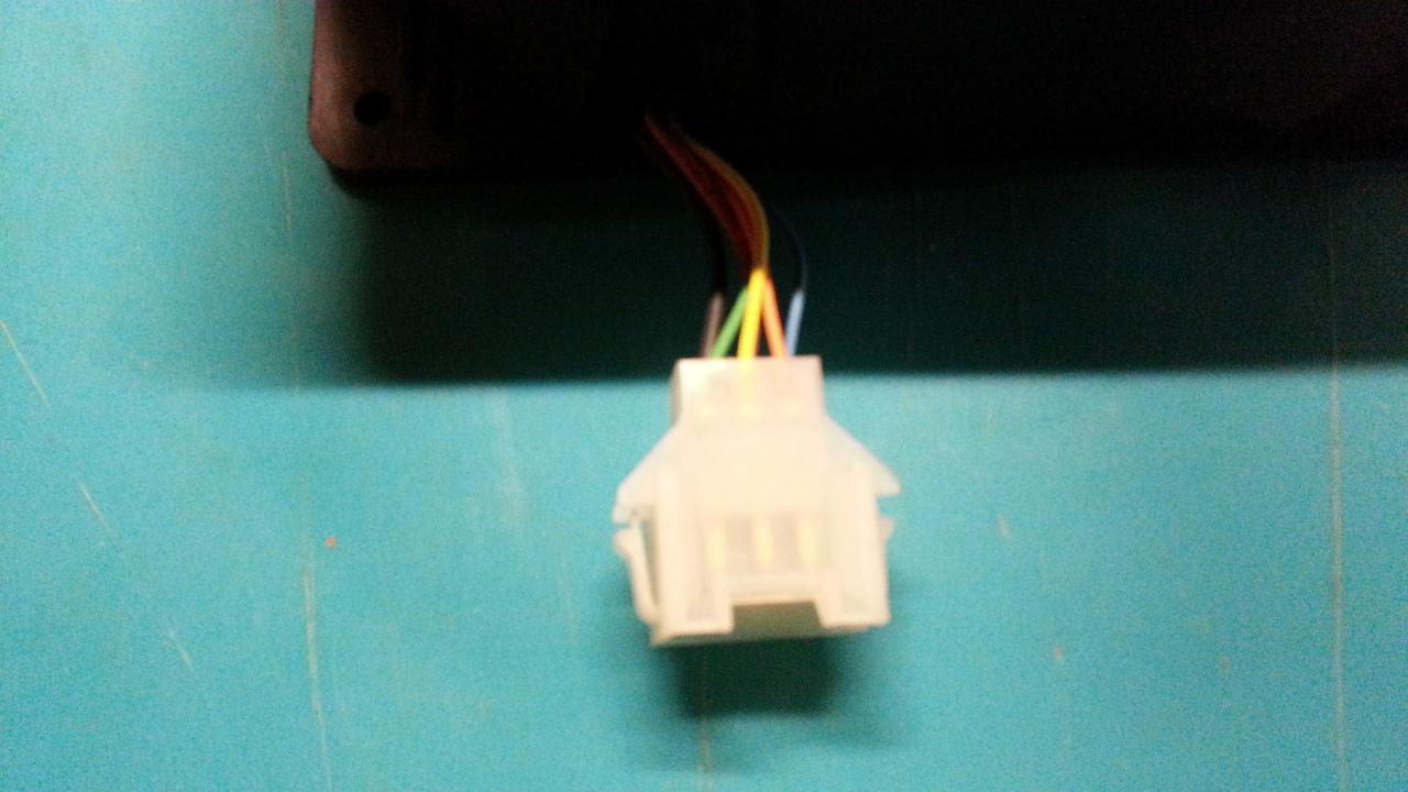

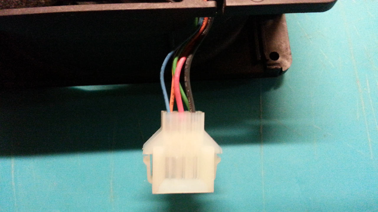

A few days ago was an old HP pro liant 740 server recycled and any part i´ve rescued. One power supply and one fan.
The fan was a very strong version . It use 12V an 10A for work !.
But it use an 6 pin connector .
I do not point where and what must be connected with it the fan to 12 volts can be pursued.
Any ideas ?

I think it´s an brushless with 4 pin control.
Not an stepper motor.
old data sheets from manufacturer exist as an 12V direct version ( Beta V Series)without 4 Pin control.
But any versions exist who not exist any data sheets.

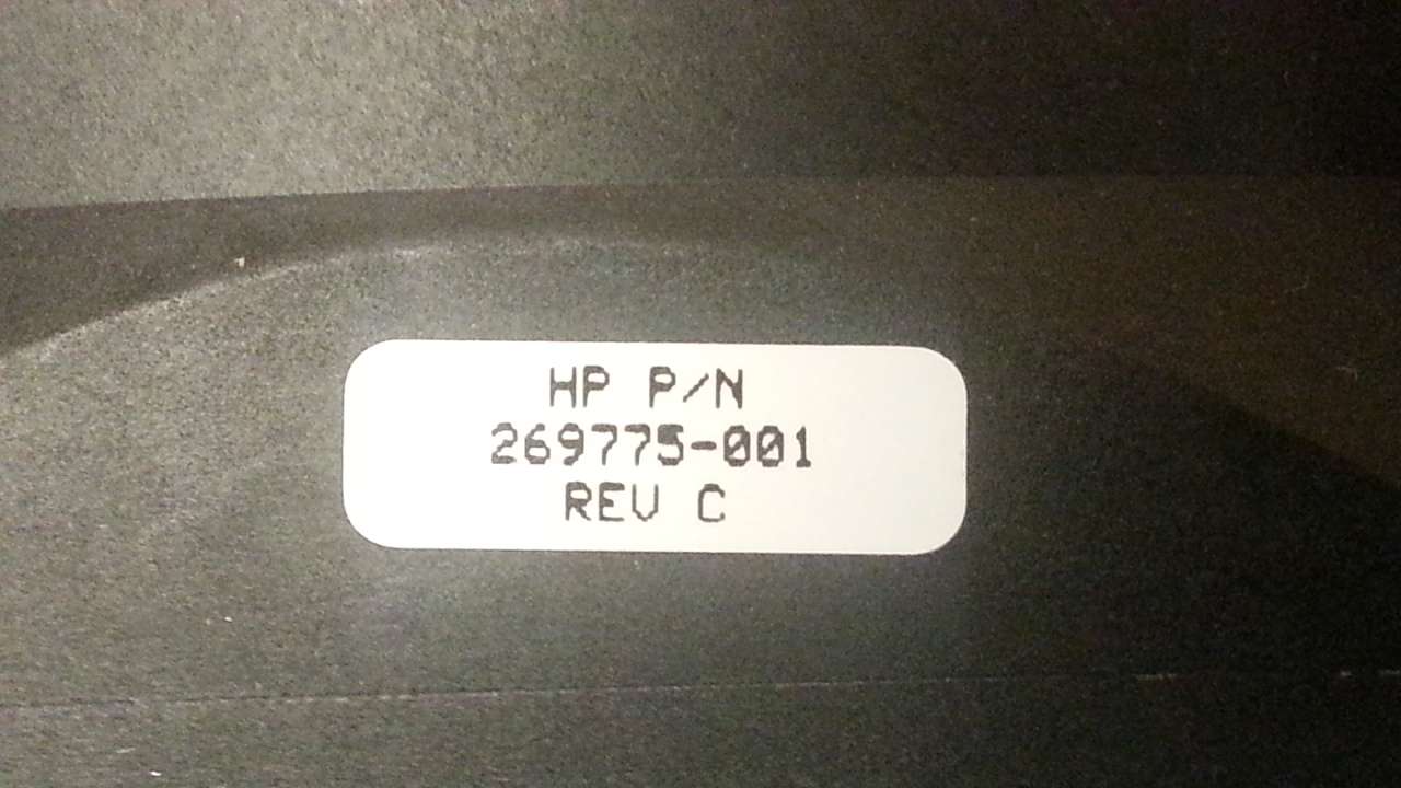

One version was an HP version ( see pics)
Support from HP give no Information over connections .
How 4 pin to works i don´t know.
Any ideas ?

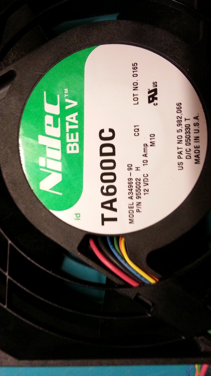

I have had a look at the fan sometimes closer and, besides, a small label still found with data on it .
Maybe this can also help?
I have already seen many fans models.
The highest Pin connections had been 4 Pins.
Adaptors of 3 Pin on 4 Pin are also known to me.
They can be all put on with the standard power on 2 Pin Easily pursue. So + and - DC
6 Pin model here in the thread is new to me and, hence, I am surprised why it with 12 volts DC put on the standard Wire on red (+) and black (-) does not work.

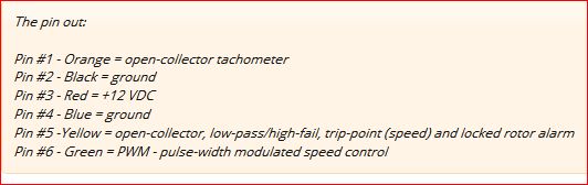

I think I may have found the pin-out for this fan:
Black - ground
Blue - ground
Orange - tach
Red - 12v
Green - PWM
Yellow - Fan Out of Spec Indication(Basically a failure output)

This is for the Nidec TA500DC A34538-90 CQ2 DC 12V Beta V series fans:
Minimum connections to get fan to turn:
Negative DC (Gnd) to Black or Blue wire (preferably the Black wire)
Positive DC (12V) to Red wire
PWM (Pulse Width Modulation) signal to Green wire (this is the signal that will actually make the fan turn at speed).
The rest are fan feedback signals which are not needed for this test.
