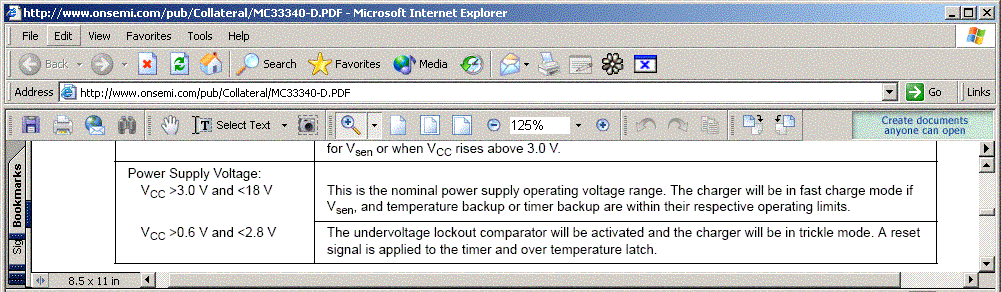

In a discrete circuit, this assumption may be true. In this case, the IC is taking care of some voltage comparisons, so it is best to stick with what the datasheet explains for the input voltage:
