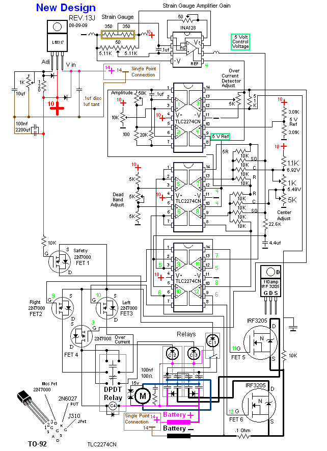

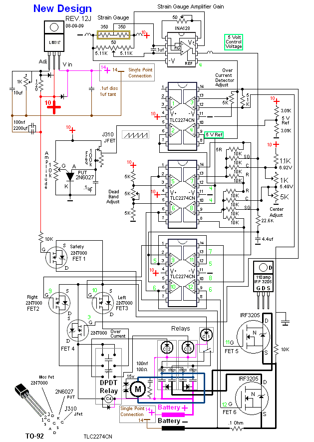

Here is where I'm at with my steering controller and I was wondering what you guys would recommend I use in it. Are there any advantages of one oscillator over the other or is an oscillator just an oscillator and it really doesn't matter.
Thanks,
Kinarfi

I don't have a favourite, it depends on the application.
What is your favorite op-amp and favorite comparator?
Sort of like asking "what is your favorite tool?".
It depends on if I need to hammer a nail or saw a board.
...Are there any advantages of one oscillator over the other or is an oscillator just an oscillator and it really doesn't matter.
The answer depends on required frequency, stability, waveform, size, cost, power consumption, what you have on hand...
The TLC2274 that you chose is actually a pretty good quad opamp. And fairly priced too. You can get better performing duals or singles, but with quads you have chosen one of the best.
With respect to your oscillator question, I like the PUT-JFET combo best, but I must confess that I'm biased...I come long ways, when designing a circuit involved designing with individual transistors. So it may be nostalgia from my part.

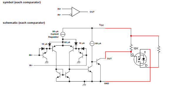

I have another question, probably get flamed for it, but, isn't the output of a comparator supposed to be a 1 or a 0??, the diagram looks like a sink, so the output needs a pull up resistor to give you the 1 or the 0. Would the FET gate tied directly to a comparator output work? no?
Thanks,
Kinarfi

Most of the i.c. comparators have a pull-down npn transistor whose emitter is tied to Vss, but no pull-up, so you have to wire an external resistor to some positive voltage source. The resistor value depends on what the output is driving, and how fast you want the output to switch high. If there is a lot of capacitance on the comparator's output pin, and you dont care how much power you burn, then 470 Ohm to +5V might be appropriate. If speed is less of an issue, and you are driving CMOS or other high-impedance loads, then 5K might be appropriate.
