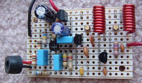

I have made most of my circuits on stripboard. It has parallel strips of copper and is perforated with holes.
Half of a pcb wiring is already done by the strips. Parts and a few jumper wires make the remainder of the wiring. One wire from a part is in each hole.
A drill-bit is used to cut strips where needed.
I plan the layout on grid-paper with a pencil and eraser.
Very tidy AudioGuru, I have just started soldering (as you know).
What does the underside look like.....
Mark
The underside of a stripboard project is very neat parallel strips of printed copper wirh a few solder joints on it. No wires all over the place.
It is the same as a pcb to remove and replace a part.

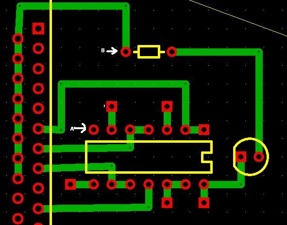

Ok Now I went for the Express PCB. It is no doubt an easy software for the beginner. Ok Now my question :D
I have drawn the following circuit (**broken link removed**)
The PCB i drew is attached.
--> What should I do if two nets cross each other? What I mean is that if i want to connect point A with B (in the image) what should I do? I am using single sided PCB!
--> Any suggestions regarding the PCB layout?

You have some errors... pin 6 does not go to ground, pin 7 does (route it between the pins on the connector.) Also pin 14 goes to +5v, not ground so it cannot connect to the cathode of the LED.
May I suggest you enter the circuit into ExpressPCB's schematic editor ExpressSCH? You can then link the PCB to the schematic such that the PCB editor will show you which wires to connect where using what is called a "netlist". This will ensure you don't make mistakes in laying out the PCB.
Except of course when you make a mistake in the schematic... :)
P.
You are doing great! Try not to get in the habit of making the traces 90° in the corners, this is because the thinner ones might not etch correctly.
And don't forget to use text to identify component.
ON single sided boards there are times when it is necessary to make jumpers, just drop a pad in at the proper place and use a yellow line to indicate it is a jumper.
Here is what I would do with your question:
https://www.pbase.com/sinoline/image/94396269

Sorry the point A was marked wrong!
And i ignored the Led's cathode and anode because all i need was two holes with correct spacing for the led!
