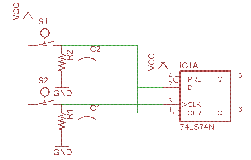

Right or Wrong?
It doesn't really matter what you use as long as it works and your circuit should work. There are always many solutions to any problem. There are circuits that use less gates. If you want to use only one gate you could use a D latch as shown. Q is held low by the CLR input until the ARM switch (S1) is closed. The next time the door switch is closed it clock a high onto the Q output until the arm switch is opened again.
Thanks for the solution hdc090460. Do you know if the 7474's clock works on rising or falling edges? In Multisim it uses falling, but this might not be the case in real life.
If it uses falling edges, then this design will actually work better for the purpose, as the alarm can be activated with the door closed without ALARM_SET instantly going high.
My data sheets show it as a rising edge, which is why I drew it that way. But if you want it the other way, take the door switch to gnd and your ripple cap and pull down to Vcc. This will give the rising edge on switch open.
Sorry, I meant to say it'd be best if it used rising edges, not falling.
