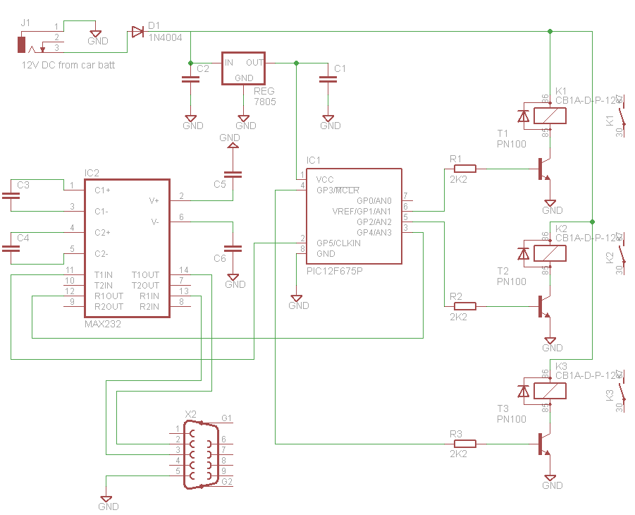

I am building a three channel relay board to power up/down my inverter, air compressor and 12V outlet panel via RS232 commands from a control panel.
It is working as drawn on a breadboard, I want some experts to look it over and provide feedback before I mill a circuit board and assemble it. A whole lot easier to change now than later!
Is it ok to drive 12V Bosch style automotive relays with a single PN100 transistor via 5V to the Base? Can a transistor switch 12V from a 5V base signal or are they intended strictly for current amplification at the same voltage level?
The relays have a coil rating of about 95ohms and draw approx 100mA and are rated to 40amps on the contacts.
Thanks,
David
With 5V at the base with a 2.2k resistor, you'll be able to push about 195mA through the relay. (The datasheet for a PN100 looks like it says the hFE is about 100). Assuming the relay operates on about 100mA, you should be fine. The power dissipation also shouldn't be a problem, the PN100 can handle up to ~625mW.

The PN100 has only a gain of approx 10 at 100mA, so the 2k2 base resistors will not drive the PN100 hard enough to saturate.
I would suggest 2N2222, which has a much higher gain at 100mA, approx 150.
Also reduce the 2K2's to approx 470R.
Use a separate diode to feed the 7805 reg and increase the +5V rail caps.
The bottom relay won't work as GP3 is input only. Easy to fix, simply swap GP3 and GP4.

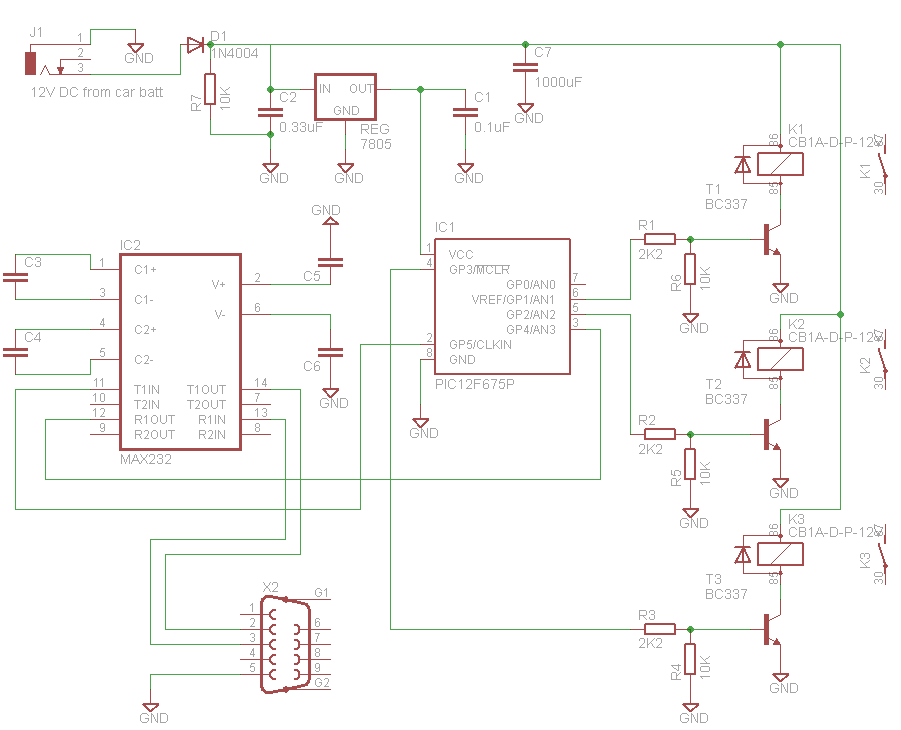

Actually, the base current is going to be the base voltage, minus 0.7V (average, for a silicon transistor), then divided by the resistor on the base. So, 5V - 0.7V = 4.3V, 4.3V/2.2k Ohms = 1.955mA. So long as your base current times DC current gain (hFE) is greater than the supply voltage on the collector divided by the load resistance, you're in saturation.
You should be able to check for saturation by measuring the collector-emitter voltage. There will be a small voltage across the junctions, but not very much when you're in saturation, if my memory serves me correctly. On the datasheet for the PN100, it says the Vce(sat) is 0.4V at Ic = 200mA, so you'll measure a little under that.
I would upgrade your transistors, as they are the part most likely to fail. I would just start with GOOD transistors. Probably BC337-40 (40v, 0.5A or 1.0A, beta 400, low sat) still in the same package.
Also you SHOULD put safety resistors from the transistor bases to ground! At PIC bootup (and/or sleep or PIC latchup failures etc) the PIC pins are floating (very bad) so 3 extra resistors will keep the relays OFF at all times unless they get a +5v from the PIC pins. 10k is fine.
I would decouple the relay PSU and the PIC psu. A resistor between D1 and C2 of 10 ohms or 22 ohms, should do it. You should probably put a big cap on the relay power (ie after D1 to ground) of maybe 1000uF.
Depending on PCB space it might be worth adding RC snubbers to the relay contacts to increase relay life and keep spikes down overall since the relay contacts will probably be attached to ground or +12v at some point.

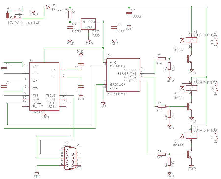

Thanks all for your much valued comments. I have updated the circuit diagram (see attached) - how is it looking now?
I'm not sure if I've placed the resistor between D1 and C2 in the correct spot - is this what you meant Mr RB?
I'm going to research the RC snubbers you speak of - are these a Resistor-Capacitor pair on each relay to reduce sparks/spikes at the contacts? Which side should they go - between relay contacts and +12V or between relay contacts and Gnd?
Thanks again,
David

You need a 10 ohm resistor (not 10k) and it goes from the right side of D1 to the TOP of C2.
I'm not sure about the best snubber values for your needs, i would just be in the same situation you are, needing to google it some more and work out the right values... ;)

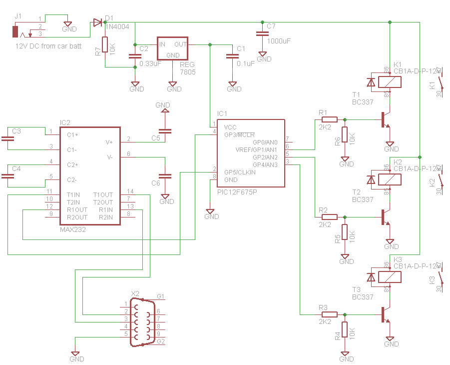

Thanks for the update - is this resistor stopping any spikes coming from the relays or other parts of the car?
Jason, well spotted - the symbol in Eagle doesn't have the Vdd and Vss pins marked!
Is anybody dissatisfied with this design? We must be getting close!
I am toying with the idea of swapping the MAX232 for an RF module and running wireless. Pros? Cons? See attached datasheet if interested. One negative is that the RF option would only allow one way communication (unless I use a MRF49XA from Microchip but I'd probably need more IO pins than the 12F675 has).
David :eek:
