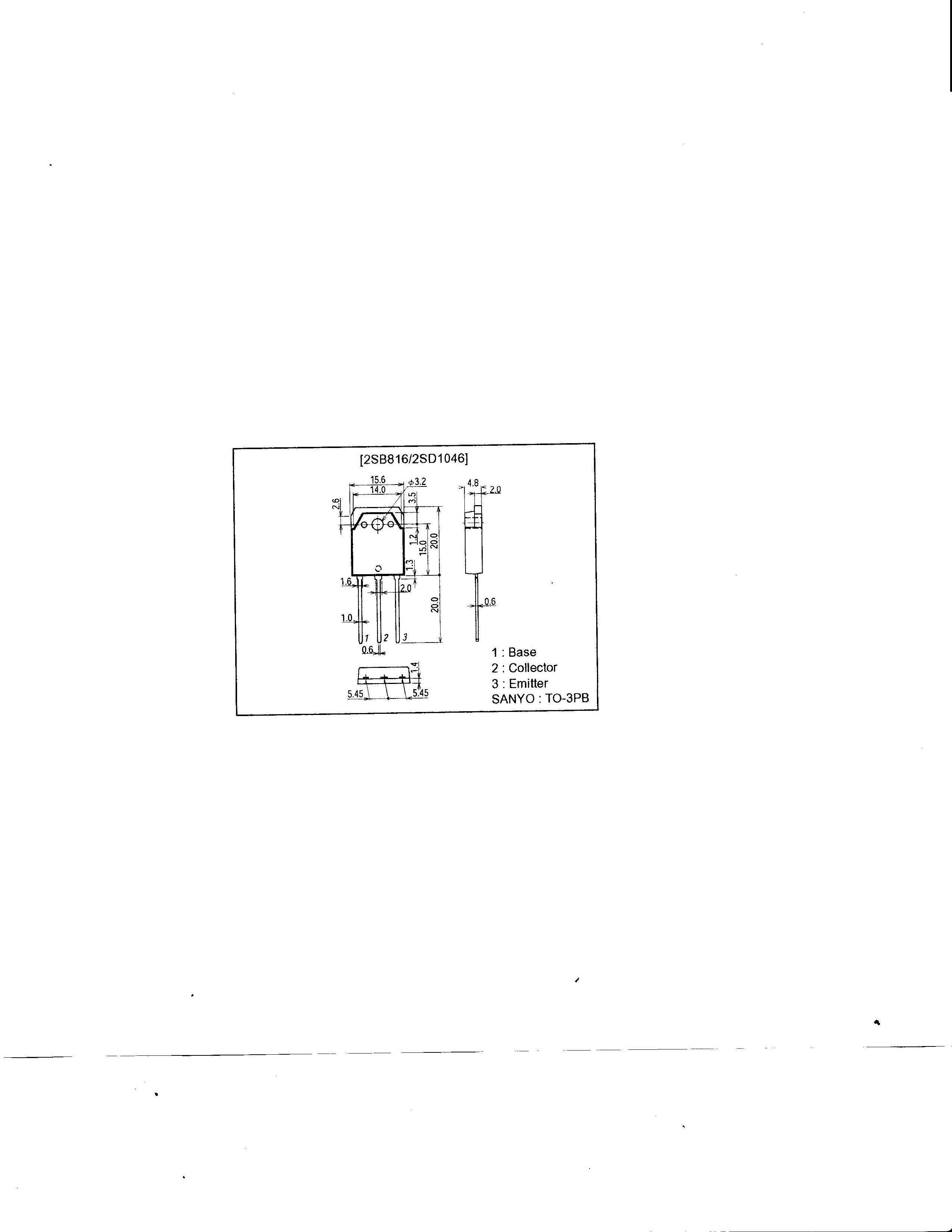

i double chked them and the readings are the same btw they are marked on the pcb board also B C E and i used the black speaker wire as my gnd and also used the chassis as gnd and used p4 as my gnd with same readings
here is the pinout of the transistors on my pcb board
Well the negative voltages all come from the -41V rail at the bottom of the circuit, and the collector goes directly to that point - so it's either at -41V (or whatever the exact voltage is on your model), or it's not connecting to the -41V rail. The negative rail must be working, because you have negative voltages on the other two pins.
But, looking at the voltages, I would suggest you have the emitter and collector transposed, with the emitter at +27.5V (which would make sense, as the other emitter that it connects to is at that voltage), and the collector at -36V to -37V, as the base is also -36/37V then the transistor is O/C emitter.

ok i ran the traces down and the collector of q18 and q19 run through those 5w 0.5 ohm resistors i mentioned then the other side of both resistors connect together and run to the output speaker wire which is +27 - 28vdc then i removed both transistors and ran a powerup test and the speaker wire had 0 vcc when powered up so could these be bad even though the initial test with the meter should they werent?
If you are still getting +28v or so at the speaker connection then the NPN output device is defective...probably shorted..or leaky
i agree here is what i did but it sounds wierd but bare with me i removed the transistors again and tested them again and found i must have missed this or wasnt paying close attention but the 2sc3236 i had replaced the 1046 with read as follows
base = black lead from meter
collector = red lead from meter reading was nothing
emitter = red lead from meter reading was same
reversed leads red to base then ran test again
collector reading was 499 wit red lead to base black to collector
emitter reading was same with red lead to base black lead to emitter
now the other replacement was a 2sa1294 this is where it gets wierd i ran the exact test above but the readings were reversed
collector reading with red lead from meter was 489
emitter was same
base = red lead from meter
collector and emitter reading nothing
its reversed from the other transistor that is suppose to be a replacement for it!!!
although the 1294 is a pnp thats probably why!!!
i had 2 more but these were exact parts tested before installing them...
now +43vdc on collector on q18 emitter is - 0.1vdc base is + 0.6vdc
now -42vdc on base of q19 emitter is -42vdc and collector is - 0.1
but now have no humming when hooked up to a speaker because the speaker wire is not at 27vdc its now at - 0.1 so at least im getting somewhere
but when a guitar is hooked up plucking string no sound so there is still something wrong perhaps 1 of these trannys are bad or something else
