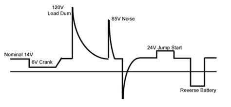

The alternator will likely be putting out 13.5 to 15 volts and you should be able to see a high brightness LED just fine.
A 15V Zener can be added. But, as the article you posted said, "most automakers utilize avalanche diodes, increasing reliability demands are driving some manufacturers to require that ECUs satisfy peak load dump voltages approaching that of the unsuppressed case." So no, no concerns.
