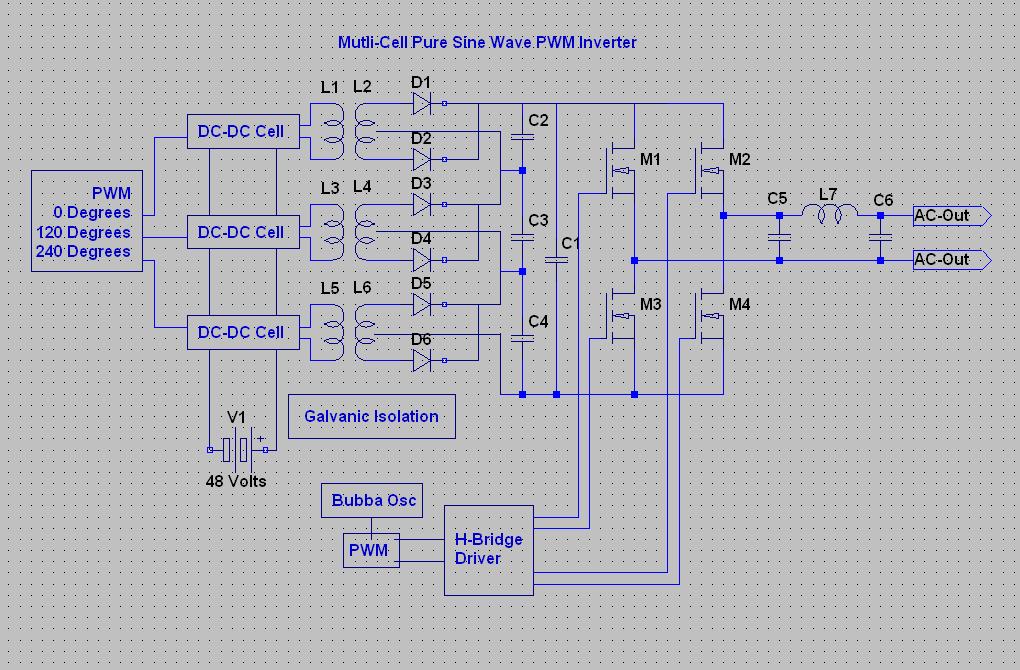

How the 0.7% THD Bubba Sine Wave Oscillator will be used in my Multi-Cell Pure Sine Wave Inverter is made apparent in the attached jpg file. Three indentical Low-Power High Frequency DC-DC Converters are connected in Parallel to the 48V Battery but their Secondaries are in connected in Series. This makes the total I^2R Losses of the three Low Power DC-DC Converters only 1/3rd of a single DC-DC converter, 66% LESS Heat Loss. The DC-DC Converters also run at 120 Degree Phase Shift to smooth out the current surges.
To double the Output Watts (1KW -> 2KW) just add three more DC-DC Modules, parallel connect the rectifed DC Outputs at C1 and upgrade the H-Bridge, as needed, for more amps.
To double the Output Voltage (120V -> 240V) just add three more DC-DC Modules, series connect all 6 rectifed DC Outputs and upgrade the H-Bridge, as needed, for more voltage.
This is a very modular, small, lightweight and cool running design.
A true Modular N-Cell Inverter would have separate H-Bridges for each Secondary.
If you don't need a Pure Sine Wave output then drop the Bubba Osc and use a simple SQ Wave PWM chip on the output.
A very similar design was reported to have 96% efficiency.
Sounds good in theory.
Have you actually tried running 3 high frequency transformers in series and 120' out of phase?? :eek:
No, I have not tried running 3 high frequency transformers in series and 120' out of phase. At first glance, I do not think your suggested design change would work for my Inverter unless you also changed the secondary portion of the schematic to a Wye or Delta config - that might work for you. A Wye Design? Hmmm, that could be an interesting alternative, though. You could rectify with 6 Diodes just like the output from a PM Alternator.
In my schematic (in previous post) the the Secondary side of each DC-DC Converter (the Rectified DC Outputs at C2, C3 & C4) are all wired in Series to make a Voltage Tripler. I think I will stick with that design for now.
To maintain the impressive THD from the "Bubba" (known outside TI as phase-shift) oscillator, you'll need an equally perfect Bubba PWM subsystem.
