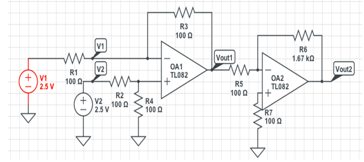

Hi there i have a nifty project i found online that i want to have a crack at and understand and will need a little help!
  1. I want to build a solenoid from electrical wire. I know how to do this, but just not to sure about how to meet the requirements of a solenoid. The solenoid must be capable of up to 2A of current. (how do i make this happen, i was thinking Iron nail with copper wire.)
  2. Once i have built the solenoid i then want to mount a magnetic field strength sensor (Linear Hall Effect)
  3. Then using OP amps i want to modify the output signal to provide 0-5V from the 0-2A from my solenoid.
Its pretty simple, but i just dont understand a few things, the circuit i have setup to modify my Vout2 is attached. Im pretty sure this is wrong so any help would be awesome!. V1 AND V2 are my hall effect sensor pins.
Thanks in Advance
Will the solenoid be energised for long periods or just in brief pulses? You will need to choose your wire gauge accordingly (and depending on whether the solenoid is enclosed or open) to prevent over-heating.
What is the Hall device spec? Can you post a link to its datasheet?
You could probably use much higher resistor values than those shown if you are concerned about power consumption.

The resistor values R1-R4 are too low.
The output resistance of the sensor is about 200 ohm and you should use resistors at least 10 kohm.
What are v1 and v2 ?
Sensor has three pins: Vsupply, Gnd, Vout.
