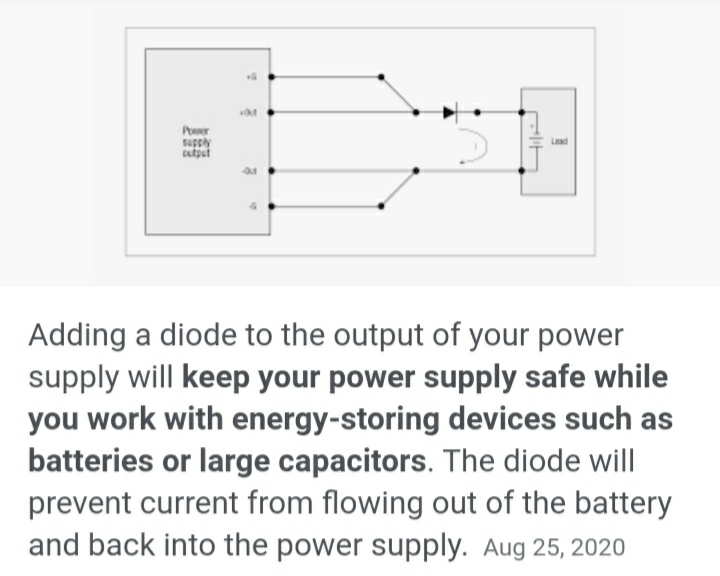

I have a question about switching power supply 5v 30 amps.
When I'm connecting it to tungsten filament wire 0.5 mm 3 cm long , after a time the power supply stops working. I think this is because of short protection. Are there any way to bypass this or you can advise me with another type of power supply.

Can you measure the current to confirm it exceeds power supply rating ?
One would be well advised to operate a supply within its ratings, for safety reasons

If you have a filament that needs a certain amount of current, you need to supply that amount of current to it. No way around it.
Done i found the solution to protect the power supply. I added 50amp diode. It works fine now.

As for the OP, it seems very likely he's simply using too small a supply to feed it - he even states it's a 30A supply, and the heater needs up to 50A.
Im building particals accelerator. For the ion source filement ac or dc is ok. The toroidal transformer that i tried 40-0-40 300watt
So how does that work as you need 5V?.
5V at 50A is (obviously) 250W - I would suggest getting a 5V toroid, rated at 500W (or preferably more).
The 300W toroid is (presumably) designed for an audio amplifier?, and not intended for continuous full power use.

A 40-0-40 V, 300W toroid is only rated for 3.75 A. You require 50, small wonder it is overheating.
I join the chorus of everyone else who has advised you to use a correctly rated supply. There is no way around it.
