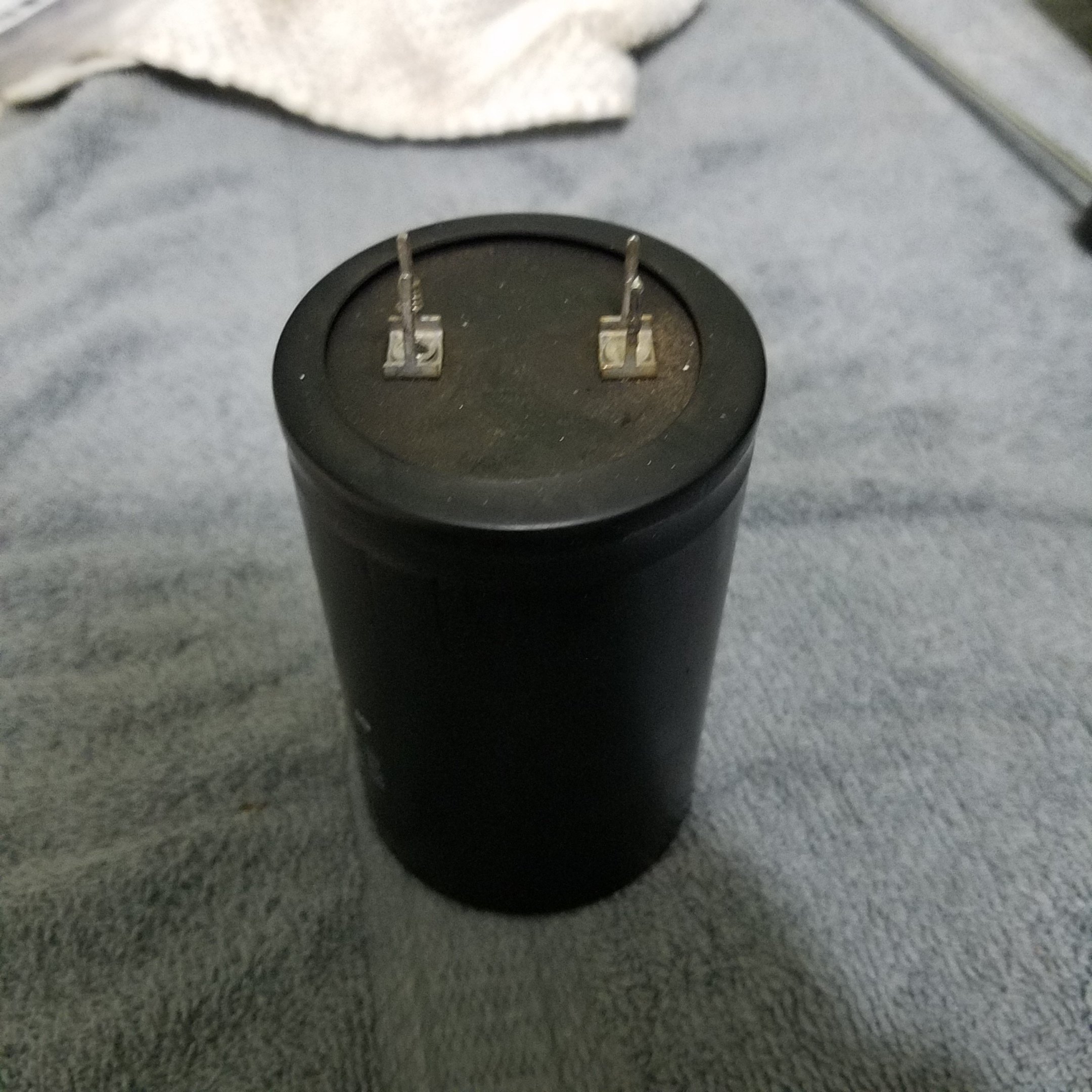

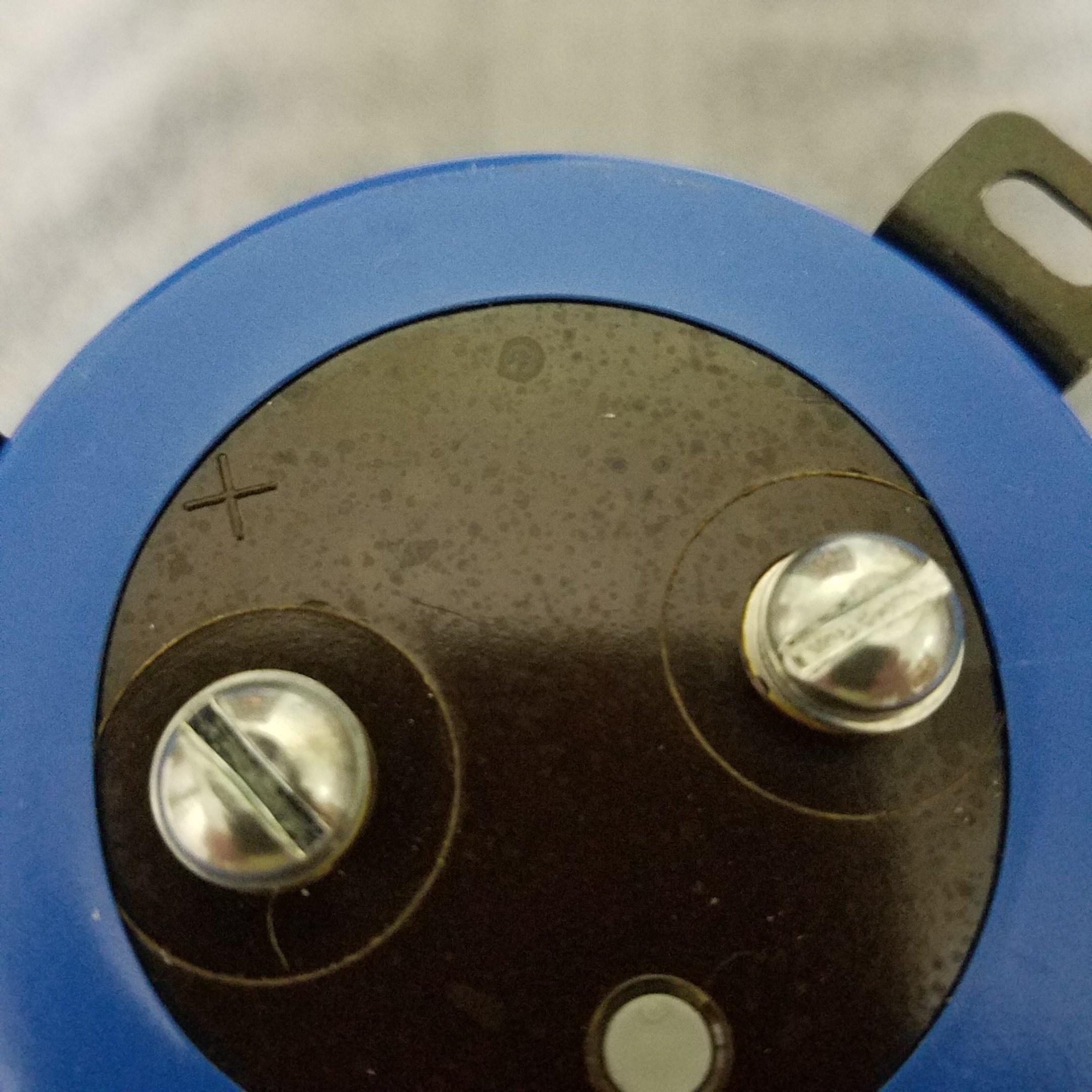

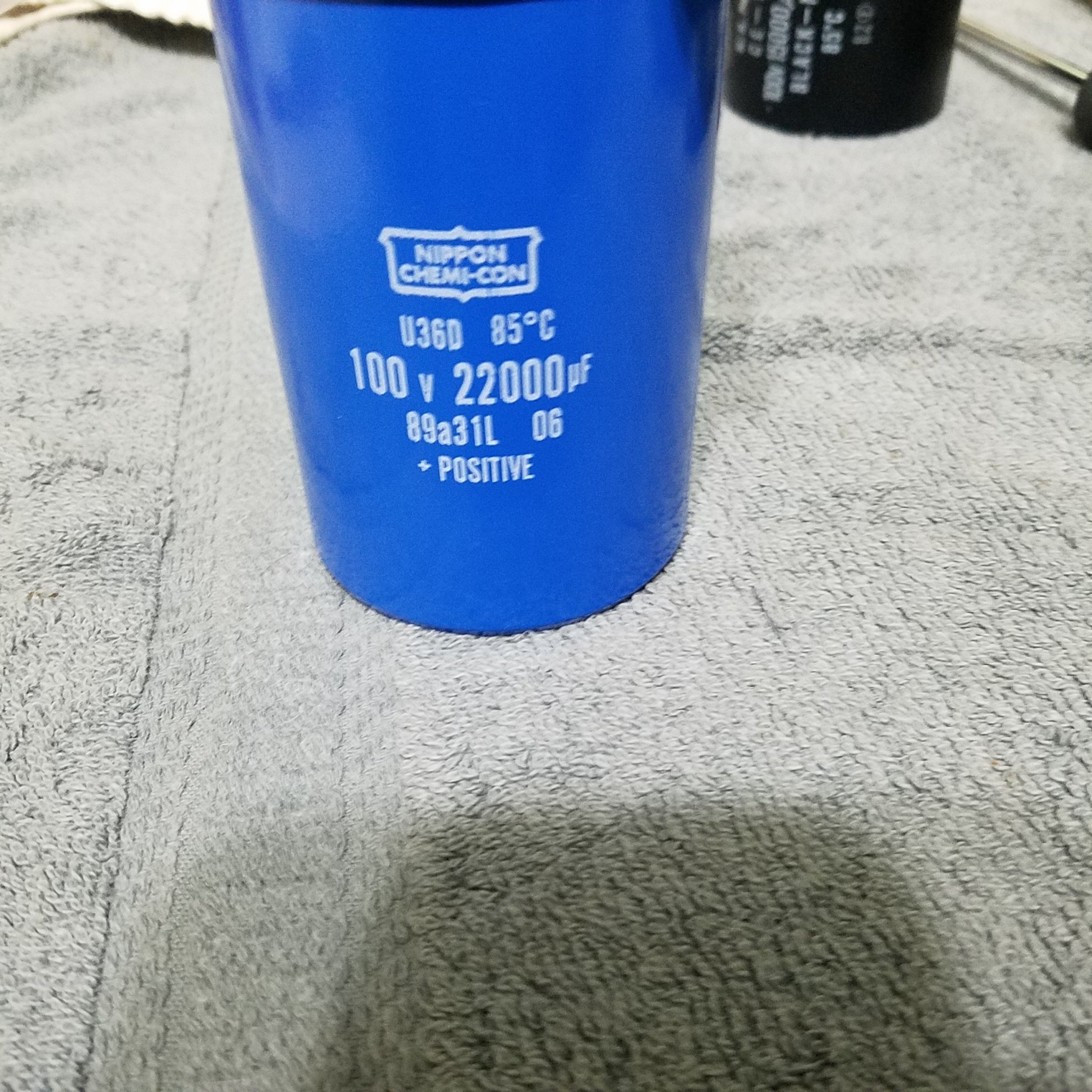

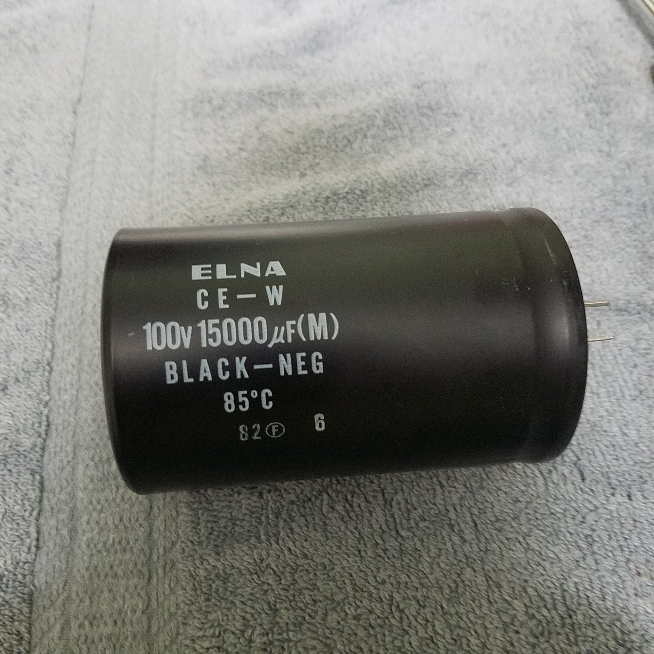

I have pioneer sx 1980 stereo receiver. Manufactured 1978-82. I have re capped all of the electrolytic capacitors except the 4 large filter caps. The old caps are marked BLACK-NEG on the side. There are no markings at the screw terminals. The new caps are marked POSITVE on the side. There is a plus mark on one screw terminal. Im not sure how to connect wiring to new caps. Help needed please.

Wiring the new caps is basically the "same polarity". That is, old cap shows -VE, new cap shows +VE, then the unmarked terminal of the new cap is -VE. Most caps only mark one terminal, and the other is simply the opposite. Two terminal caps that are marked either - or + on one terminal, is just to tell which is which. The unmarked terminal is the opposite.
Thanx for reply. I understand this. My concern is that the old caps have no markings except on the side. Print reads neg-black but does not specify which terminal is + or _

Look at the black dot on the top of the riveted point that holds the terminal solder pins - it's on the left hand terminal in the photo with the pins upwards.
That's the negative terminal identification.
