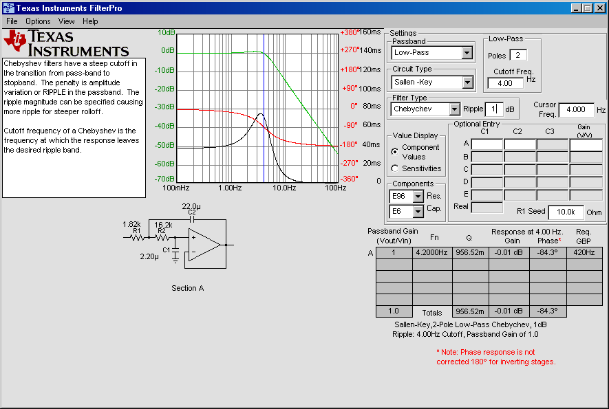

Download TI's free Filter-Pro cad program and cobble up an active LPF and try it...

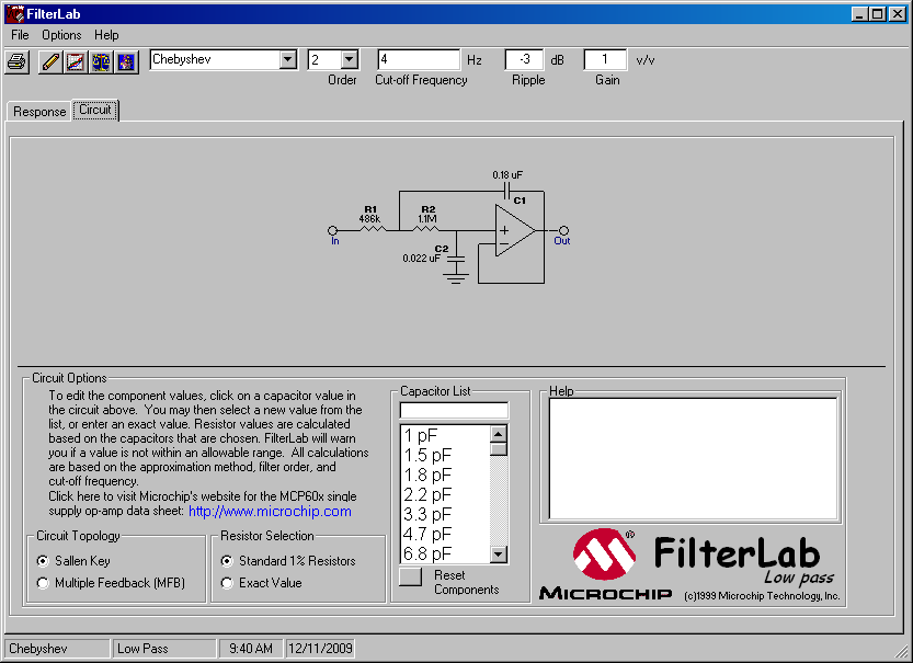

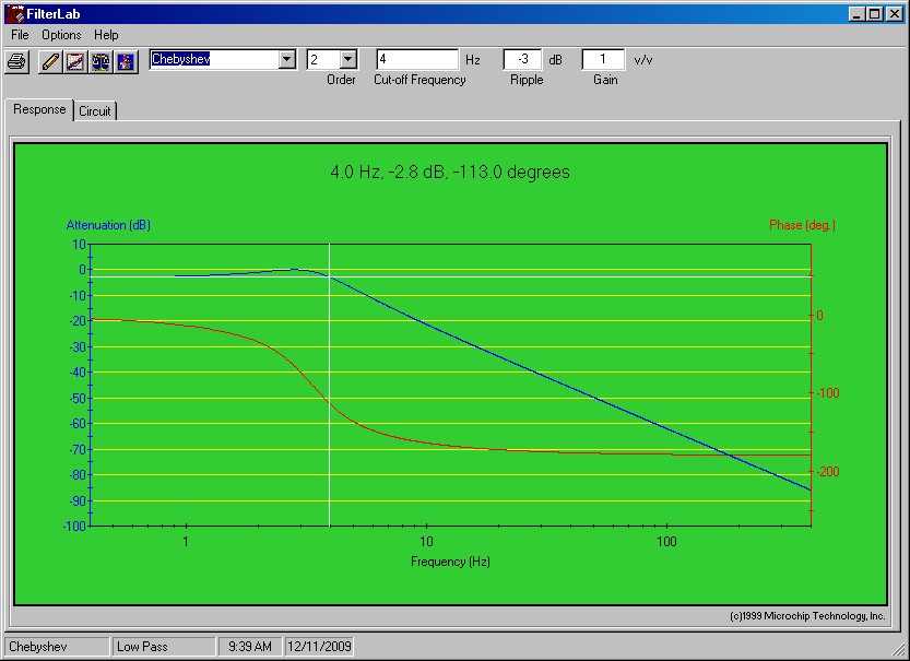

Another example from free software from MicroChip

Hi
Which topology of low pass filters do you think is suitable for filtering of thermocouples? either Sallen-Key topology or Multiple feedback topology.
Would you rather buy two resistors, or three resistors?
Hi
For your application either would be fine. The differences are subtle. For a discussion of these see Design and Dimensioning of Active Filters.

Hi Mike
Please tell me what is the meaning of Seed Resistor Value in the Filter pro V2.0 software and how can i select the desired Op-amps?
Hi Mike
From the help file:
R1Seed Value
The Seed Resistor setting allows you to scale the computer-selected resistor values to match the application. Move the cursor to the Seed Resistor field and enter your seed resistor value. The default value of 10 k ? is suggested for most applications.
When the circuit is in a power sensitive environment (battery power, solar power, etc.) the value can be increased to decrease power consumption. Some high speed op amps require lower feedback resistance, so their seed resistor value should be decreased.
Higher resistor values, e.g., 100 k Ohm, can be used with FET- input op amps. At temperatures below about 70°C, DC errors and excess noise due to op amp input bias current are small. Remember, however, that noise due to the resistors is increased by nwhere n is the resistor increase multiplier. Lower resistor values, e.g., 50 Ohm, are a better match for high frequency filters using a wide range of high-speed amplifiers from Texas Instruments.
The seed resistor value is ignored when a capacitor value is entered.
