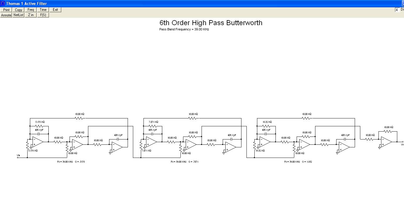

I am a newbie in filter design arena, I really need help to create a high pass filter.
I prefer it to be an active filter.
Ok, the fundamental frequency is 40kHz and I need a high pass filter with almost 10kHz of bandwidth.
Is there any expert in the field to help me to create that please?
Please consider that I have a single ended power source so the active filter has to work with that single source at 12 to 15V.

But here is a start point to go:

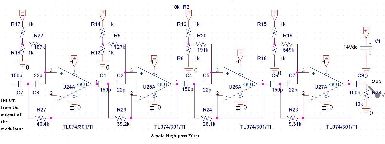

I designed it by the above software you mentioned:
The cut off freq is at 39kHz.
I am not sure if I have done it right though?
please keep in the mind that I need it for 10kHz of the bandwidth. Is is used to create SSB with carrier out of my before modulator design.

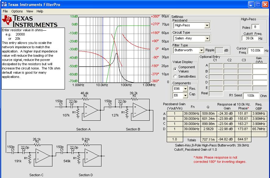

The second one is a 6 stage one too, it is made by Filter solution software too.
I even am not sure if I have chosen the right active filter (i.e Butterworth)

If I understand correctly, you are DSB modulating a carrier at 40KHz and want to roll-off everything below 40KHz to suppress the lower sideband.
The slope of the filter roll-off below 40kHz is determined by the filter order, which determines how much of the lower sideband is suppressed. A 6-pole filter, as you showed, rolls off at the rate of 36db per octave of frequency.
If that roll-off suppresses the lower side-band sufficient for your purposes, then the filter you generated in the Filter-Pro attachment should work. Do you have any questions about that filter?
The modulation bandwidth of the circuit is limited only by the op amp frequency response. If you want to limit the bandwidth for any reason, then you could add a low-pass filter. For example for a bandpass of 10KHz you would add a 50KHz low pass filter. It could probably have fewer poles then the HP filter since that filter is not so critical.
To use the circuit with a single supply you will need to connect the points shown going to ground to a pseudo-ground at 1/2 the supply voltage (as shown in the previous reference I mentioned) and use a coupling capacitor at the filter output.

What was the DC voltage at the output of your filter?
Of course it will work if it has the correct parts and is powered and biased correctly.
Post your filter's schematic showing the opamp's part number, supply voltages and biasing for the opamps.

Are you guys sure that the parameters are correct for a high pass filter at 39kHz (I am reffering to the above circuit designed by the suggested software)? Again please consider that I need the carrier itself?
Two filter circuits were posted.
Which one did you make that did not work?
Both must be driven from a very low impedance like the output of an opamp.
The first circuit with only 3 opamps must be biased with a lot more than only 2 resistors.
That is why your schematic was requested.
No power supply voltage?
The 39khz filter reduces the level of the 40kHz carrier by about 0.85 times.
The TL071 barely makes a filter as high as 39kHz. An opamp is needed that performs well at 10 times 39kHz (390kHz).

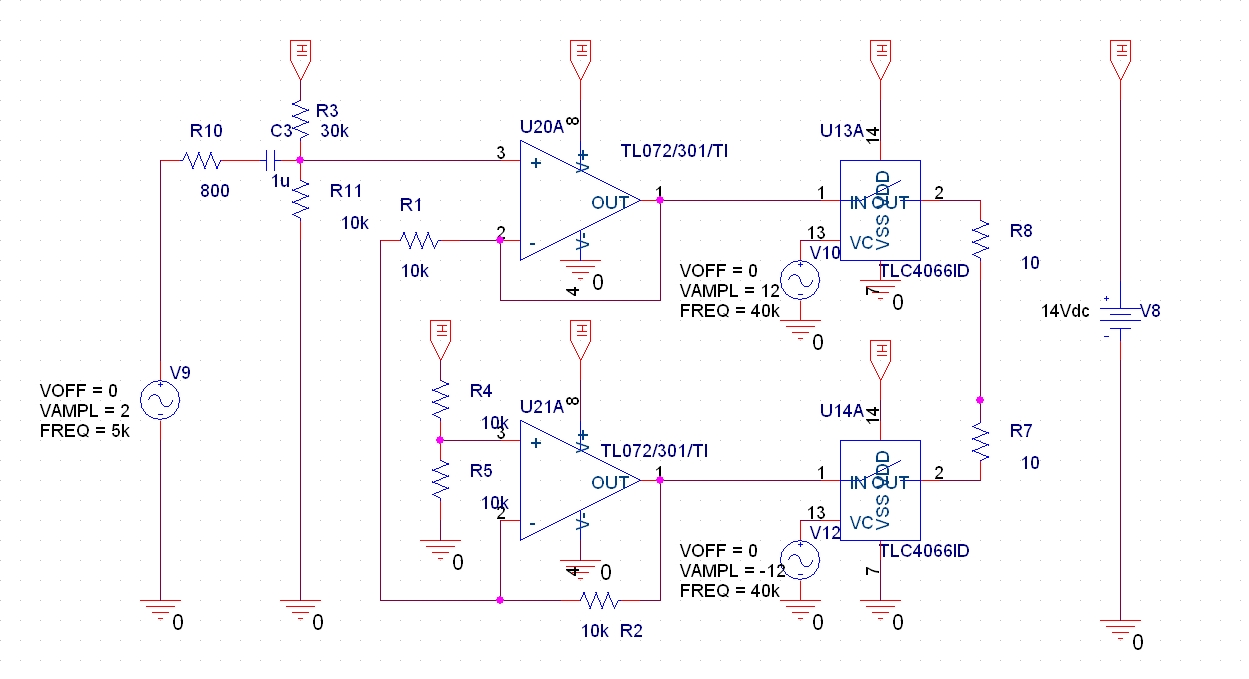

The modulator is based upon 4066 chip so the input of the filter comes from the output of 4066 (can you remember the modulator circuit at the other thread?)

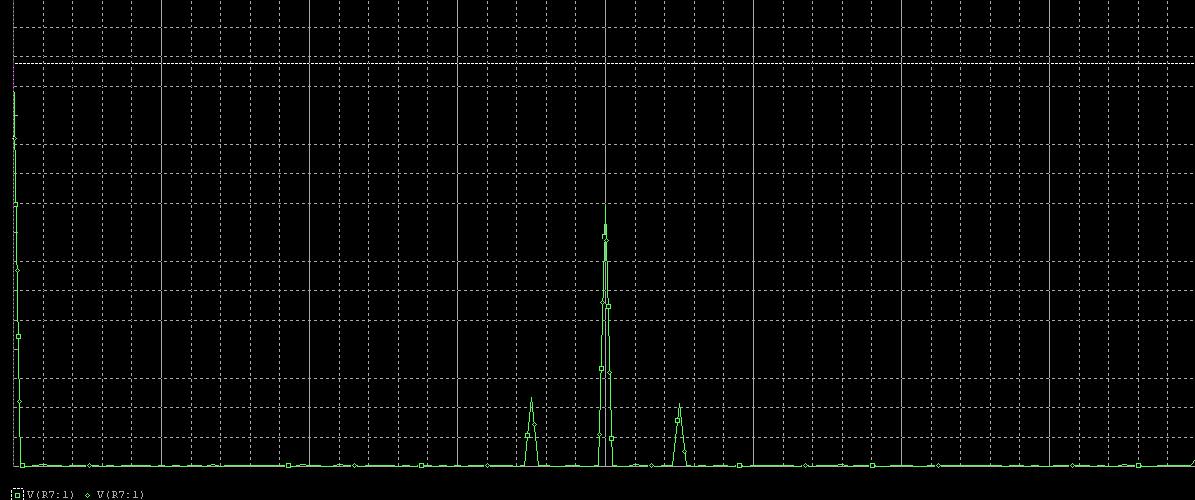

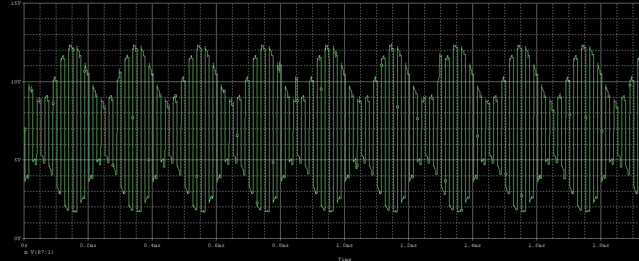

Ok here is the modulator itself, working at 40kHz and its related FFT.
please look at the FFT, It contains the carrier too.

I thought maybe you have seen a such filter circuit or can handle the softwares which are used to generate active filters so asked you if thats true please put it here (not wanted you to bother yourself by designing one)

You posted two filter schematics.
Select the one you used and use Microsoft Paint program or something to copy it and post it here showing the resistors used to bias it. Show the input voltage and frequency that you tested it with.
How did you measure the output of the filter? On an oscilloscope?
What was the output DC voltage of the filter?
Your CD4066 "modulator" does not have an output coupling capacitor and has an output impedance that is not low enough for both filter circuits.

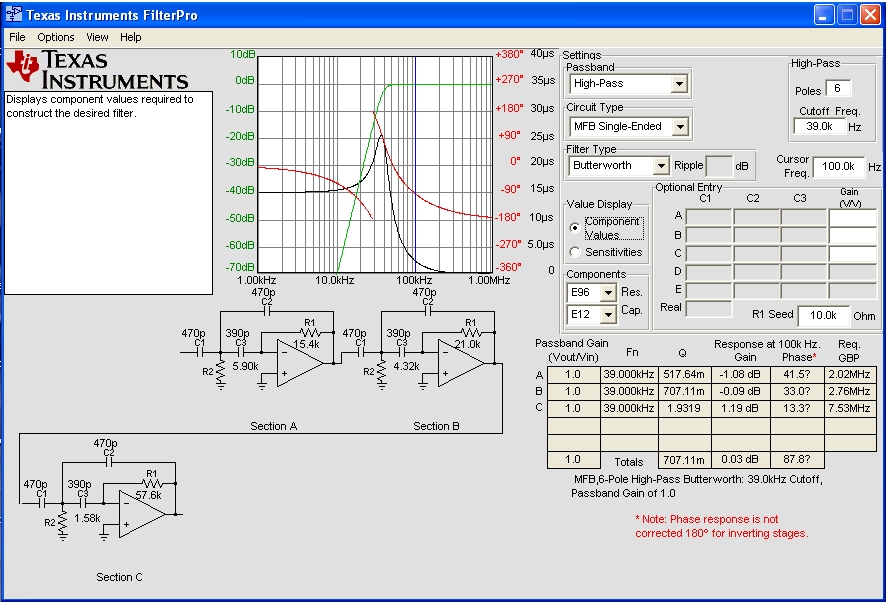

Ok here's my new filter design. It is designed by 'FilterPro' (the software suggested in this thread)
this both pictures are the same, I just put the first picture to show the biases in real circuit.
Are you thinking that this filter does work at 39kHz and removes or attenuates the loser sideband? (I need the carrier and the upper sideband at the output of the filter). Please keep in minde that the input bandwidth is almost 10kHz.
Any suggestion would be appreciated.
P.s did you care of the single power supply and the 1k biasing resistor?? No need to capacitors for them?
