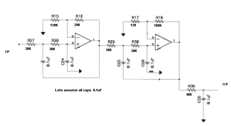

I have been given this schematic (hard to see, low resolution) , can't get the original source as shown, can anyoune guess the corner frequency/ poles in this filter . The filter is for interfacing to ADC . I uess butterworth/sallenkey ??
Regards/
It's a couple of cascaded Sallen-Key low pass filters followed by one more R/C pole.
If you want to annotate the schematic with your best guess as to component values, it wouldn't be too hard to determine the pole frequencies.
Thanks , but still can you guess the cuttof frequency and the number of poles this filter might be providing for ADC.
Hi Dark,
It appears to be a fifth order filter but you need to draw or scan the
schematic better to show the component values if you want someone
to tell you what the cutoff frequency is. The pic you posted is too
blurry to see the component values.
The number of poles will most likely be 5.
Hi MrAl ,
I too cannot see it properly its blurry in the pdf , anyways I guess the components as attached below.
Regards
-Adi

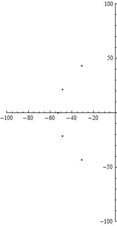

These plots were generated using the annotated resistor values, with the value 120 changed to 120k (edited in response to audioguru's comment). The capacitors were all assumed to be .1uF. The gains are not in dB, but just the numerical gains. The frequency axis is in Hz.
The first image, Plota, shows the responses of the various stages.
Red is the response of the first opamp stage, blue is the response of the second stage, black is the response of the final RC roll off. Green is the overall response.
Plotb shows the pole positions. The pole at -40 + j0 is due to the final RC roll off. It looks like it's a little off if the goal was to get a Butterworth response.
Plotc shows the pole positions if the resistor associated with the final RC roll off is changed to 30k.

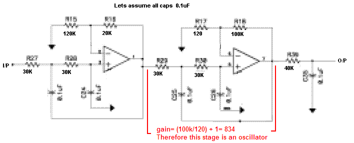

A 2nd-order Sallen and key filter oscillates when it has equal component values and has a gain exceeding 3.0.
The second filter with annotated parts values has a gain of 834 so it is an oscillator, not a filter.
I think the simulation used 120k, not 120 ohms.
The first stage should have a little more gain to add some peaking so the total response of the filter is flatter.
The attached plot is as before (with the R in the final RC changed to 30k), but with the addition of an ideal 5th order Butterworth characteristic in yellow-orange.
It just goes to show you that it's not enough to get the poles on a semicircle; they have to be at the right places on the semicircle.

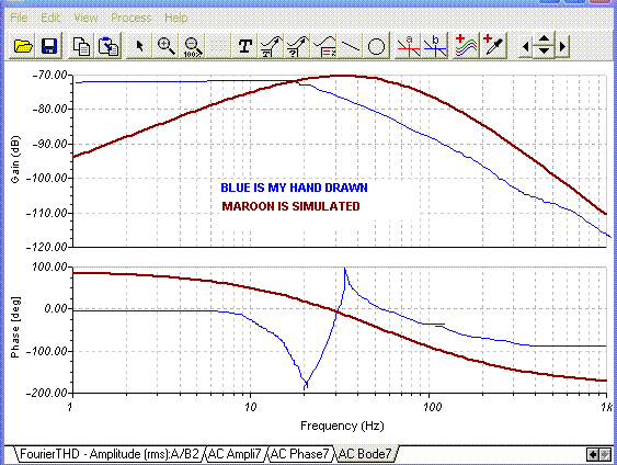

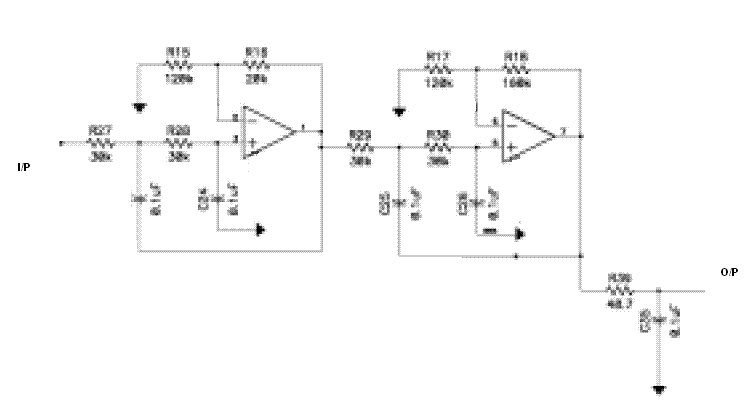

Hi All ,
Thanks for the help . What is troubling me is the response isnt flat as simulated by "The Electritian " (what software you use). I am attaching my simulation below and draw in color BLUE with hand what is likely to be expected by the input side of the ADC . The cuttof frequency looks like to be 30Hz or around it . But I am afraid the resistor and capacitor values arnt doing a good job.
This shows that I couldnt guess the resistor values exactly but it was pretty close . Now as I have attached the requirement can anyone suggest me the values of R and C in reverse engineer .
One more question as we are feeding a DC to our ADC , then what does it means to leave this 25-30Hz at the input ? , it should have been cut off as low as possible 5-10Hz with some attenuation to the 60HZ humm as well.
The sensor is a PZT type which oscillates when when measuring at low frequency due to its placement on a moving vehicle .I think it shoould be filtered much lower then this to get more clean DC or its an over kill!!
