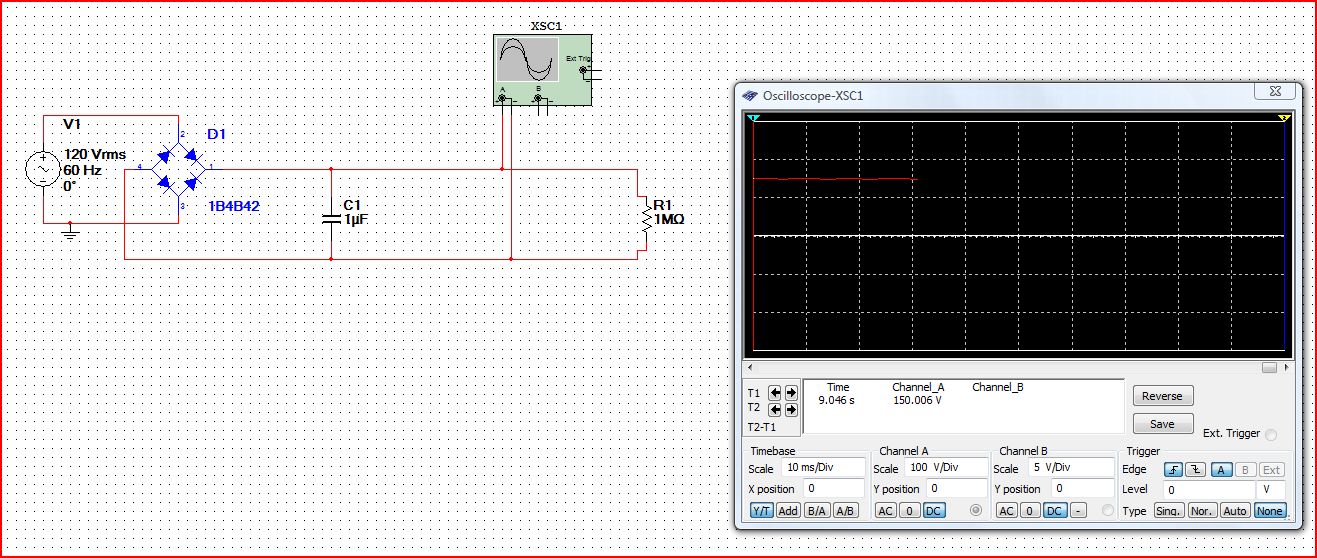

Being that im in canada our AC is 110VAC @ 60Hz.
if i attach a full wave rectifier to it, how do i calculate the capacitor i'll need to smooth it out?
The value of the capacitor depends on the load and on how much voltage ripple you can stand. You could get a circuit simulator, draw up your circuit and play around until you get the result you're after.
I do have multisim, so ive been playing around with that.
but the the rectifier seems to be capping at 135VDC instead of the 165V i should be seeing.
The peak of 110VAC is 155.5V. If the rectifier is conducting a few Amps then its voltage drop is 1V. The filter capacitor is quickly charged to 155.5V then slowly discharged before being charged again on the next pulse.

Doing this in multisim, using a rectifier and a 1uF cap, the oscilloscope shows the voltage "smoothed" to 147-150, but a virtual probe shows it still spiking between 3V-150....
a 1uf capacitor is much too small to be a power supply filter capacitor. Use hundreds of uF or thousands of uF.

ive got to be doing something wrong here.

Vr(pp) is approx equal to (1/f*Rload*C) * Vp(rect)
where
Vr(pp) is the peak to peak ripple voltage
Vp(rect) is the unfiltered peak full wave rectified voltage
f is the frequency of the full wave rectified voltage, which would be 120Hz in this case.
Since your 1M load has such a low current then the 1uF filter capacitor works fine.
But the DC voltage should be 168V, not 150V.
With 30 LEDs as a load then the 1uF filter capacitor is much too small. The voltage will be pulses at double the mains frequency. You might see the LEDs flicker at 100Hz or 120Hz. Since the voltage has such a high amont of AC ripple then the LEDs are turning on and off and will appear dimmed. Be careful that they do not burn out if you add a much bigger and better filter capacitor.
