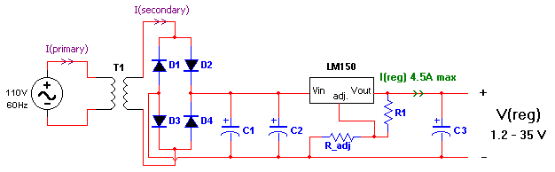

I have a transformer that I want to find it's winding's reactance, how could I do so? The reason that I want to find the reactance is that I want to calculate the current in the primary winding of the transformer. I will use the following eqn. :
I(phasor) = V(phasor) / [ R(winding) + j w L(winding) ]
V(phasor) is 110 Vac (from mains) (considered to have zero phase angle, right?)
R(winding) could be measured using an Ohm-meter, right?
w = 2 * pi * (60Hz)
Now, for the L(winding) .. how could I find it ? Or am I doing the whole current calculation thing in a wrong way??

Could you clarify that please? At the moment, no I don't have a secondary load. However, I'll add one later. What I am building here is a power supply, and I am trying to figure out the maximum current that the primary winding could handle. That's why I am calculating the current and inductance.

No, the 4.5A is the maximum curret the the LM150 would output. The secondary current would be larger than 4.5A. I've attached the circuit that I am working on. Have a look at it ...

Kypo, Ohm's law is I=V/R. As R goes down, I goes up. A low R is generally called a high load (because the current is high) unless you specify high load resistance. Also, in a transformer, primary and secondary currents are proportional (ignoring magnetizing current, which you are trying to measure, and I believe are unnecessarily worried about). As secondary current goes up, primary current goes up, and vice-versa. With no load (secondary open), you will have negligible primary current.

This was why I asked earlier about the intended load, for most purposes you can consider a mains transformer a 'nearly perfect' machine, they actually have a very high efficiency.
Basically the power in the primary is the same as the power in the secondary (obviously there will be a slight loss, but it is quite slight). So if your secondary output is 11V at 10A, your primary input will be 110V at 1A - both 110W of power. If your secondary current reduces to 5A, the primary current will reduce to 0.5A - and if the secondary current reduces to zero (no load) the primary current will reduce to a fairly low value, near enough zero for most purposes.
So you seem to be chasing complicated calculations for no reason, as your original premise is incorrect.
You would normally fit a fuse in the mains to the transformer for safety reasons, or at least use a transformer with a built-in thermal fuse, if the transformer goes shorted turns (or an external short is on the secondary) the transformer will cook itself, so it's important for safety.
Apparently you haven't considered that the primary inductance of a 60Hz power transformer is typically on the order of several Henries.

The power factor is relating to the primary side. At no-load, the primary will display a low power factor (maybe 0.4-0.5), and this increases, approaching 1, as you increase the secondary load.
The secondary power factor depends entirely upon the load - if you have a purely resistive load on the secondary, the secondary power factor will be 1.0
