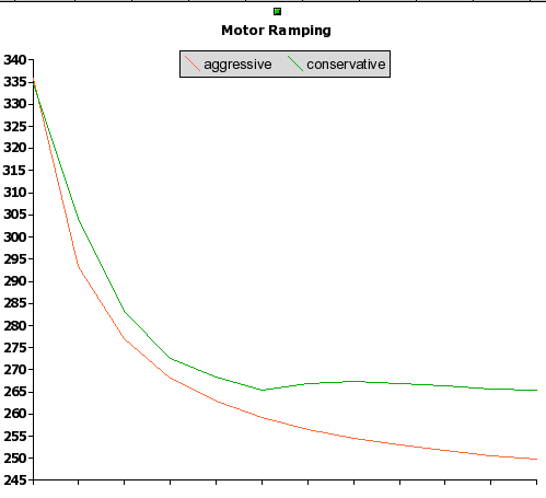

i was using steppers before but i'm confused by the formula.
where did you get it from and are you sure Y is frequency?
is X varied too or it is constant? did you check what graph of
this function looks like? assuming fixed X for simplicity,
it must have big disturbance around 0 while sides get pretty flat
only few steps away from zero. imho this formula leads to dead end
unless there is something you didn't mention.
to run stepper at higher speeds one has to ramp up speed (freq.)
and when close to target slow down. that lools like trapezoid
which is very different from what your formula would produce.
am i missing something?

Hello,
Yes I have graphed it (see attached image). The formula above corresponds to the orange line (what I named aggresive). I am not sure where I picked it up from ... trawling through the internet on a google search. The numbers on the Y axis represent the delay between each step (Y in the formula above), and on the X axis the numbers of steps (I only graphed 12 steps to indicate what would happen in the second scenario).
Y is the delay between each step
X is a base 'smallest' delay between each step (constant)
N is the number of steps that have been taken (varies)
So, we start with a slightly larger delay between steps and then progressively shorten the delay, increasing the step frequency, motor goes faster. A comparison is made such that, if Y < X, X is used as the delay. Complimented with overvoltage and PWM there is no disturbance. You do need however to 'tweek' the X value, especially under load, to ensure you are not pushing the motor.
The green line is the scenario that you outlined and it involves more than basic math. As it is more complicated, you can appreciate why it is not used.
I have implemented the suggestion by Nigel and Mike(Pommie) and used a table instead of doing the calculation. It has involved reprogramming the pic a couple of times .. but K.I.S.S.
Hope that helps to clarify.

Nigel Goodwin said:
If using a table (which is by far the most sensible solution!) there's nothing to stop you using the more complicated option - it makes no difference to the PIC, it still just reads from a table.
Yes true, the formula used to graph the green line needs to know how many steps you are going to step in advance (I put 12 there for the graph). The table size is dependant then on the number of steps. Add any sort of gearing to the motor and poof ... the table could potentially be large.
This is the reason for going with the `simpler` formula, as it is easier to work with (creating a table and such, lesser of two evils ...).
I suspect there's probably only a small number of values that will have any effect? - it's a mechanical system, and making small percentage changes probably won't make any measurable change. But you would have to run tests to see what changes are worth while - which is probably a good idea anyway?.
