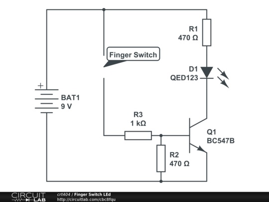

How can I replace to push button in circuit 1 with the finger touch switch in circuit 2?
Yoav
You could try this. The 555 is wired slightly differently in this version. The 4017 and LEDs are not shown.
