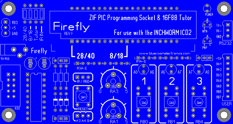

Here's the first draft of the new Firefly PCB. It's the same size as the Inchworm ICD2 PCB.
Thanks to suggestions in these forums the schematic is complete, I'll be picking two winners of the free PCB in the next day or so.
I've added a 5V power jack and I just can't squeeze much more on the PCB.

It is looking good.
It wil be single side or double side PCB???
Which software u r using for making PCB???
Two bad it is double sided, but that is a lot of parts on there.. No time this weekend to etch a board anyway.
I see you are going to do some Atmel stuff.. Nice chip. I really liked the mega8..
Range finger for the board? Bot guys will want that. Or just a new toy :)
More on the user connector would be nice.

Well I finished hand routing the PCB (lots o work that).
If it checks out vs the schematic I'll start PCB production Monday
Looks nice Will.. Beyond a couple chip and single sided for sure, I am impressed.. BTW, have you heard from Mike K8LH? Do not think I have seen him posting. Will EMAIL him.
