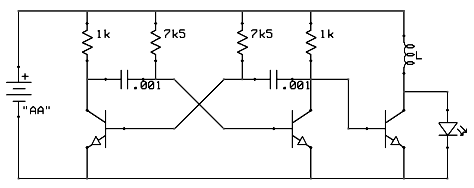

Heres a circuit I designed/build that will power just about any LED off of one "AA". I have this circuit built and sitting on my desk right now. It has been running a red LED off a "dead" (.7v) AA battery for 48 hours now. It works very well and can even run several LED's in series(I tryed up to 4). Inductor is about 100 turns of 30awg wire on a 3/16" x 3/4" ferrite core. All transistors are generic NPN and all component values are non-critical.
You should include a resistor in series with the LED.
Someone Electro said:
Shodnt the led be put anitparalel over the inductor?
It makes no difference, electrically the LED is already in parallel with it (the positive and negative rails are the same at AC).
And, as already suggested, there's no resistor needed for the LED - which is obvious if you understand the simple circuit!.
