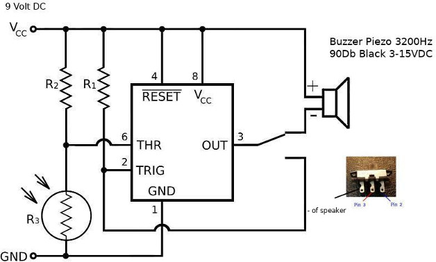

I put this together on my breadboard. The author said that R1 was probably not needed, so I did not use it.
I do not have a potentiometer, but tried a 110 and 530 ohn resistor for R2.
With no power to the circuit, laser shining on the LDR, the reading was around 195 ohms.
I shined laser at the LDR and used the switch in both positions.

Piezo buzzer did not sound.
What can I try next?

see instrucitons:
The value of R2 should be approximately the same as the resistance of the photoresistor when you are shining the laser pointer directly at the light sensitive face.
that brings r2 closer to "12K ohm" or "12000 ohm"

I will order a 15K pot.
Which type, linear taper or log taper?
id even go with 30k,
but its a good idea to check the resistance of the dark too, and the rooms natural lighting, R2 is basically your sensitivity and dependent on the ldr.
a pot is nice for adjusting the sensitivity but for just basic testing a few resistors will do fine ... your main problem is r2 is too low in value
also holding the laser closer will drop the resistance lower .... is that how its going to be in the field?
to test the buzzer hook it up to the battery direct,
to test the switch put it between the battery and buzzer
got a voltmeter to test pin 3&6?
when pin 6 is >6v then pin 3 = 0v
when pin 6 is <6v then pin 3 = 9v

Buzzer and switch work.
Where do I put the leads for pins 3 and 6?
Like where does the + and - specifically go to?
"The value of R2 should be approximately the same as the resistance of the photoresistor when you are shining the laser pointer directly at the light sensitive face."
Do I measure that with a live circuit?

As Dr_Doggy said, look at pin 6 relative to ground. 2/3 Vcc is the magic number. @ 9V, this is 6V.
With light on the photocell, pin 6 relative to ground has to be below 2/3 Vcc. The photocell and R2 divide the battery voltage.
Instead of looking at formulas, let's look at basics . The current through R3 and R2 is I=Vcc/(R2+R3). The voltage cross R2 is I*R2 and the voltage across R3 is I*R3.
The part acts as a comparitor, latch and driver in this application. Datasheet: https://www.ti.com/lit/ds/symlink/lm555.pdf
Magic numbers are 1/3 and 2/3 Vcc for this part.

This circuit is not really a good application. It will be dependent on stray light. Remote controls modulate their output, so the IR from the sun or lamps don't confuse it. A beam break detector over large distances for an IR LED should be modulated so ambient light is rejected.
So, the voltage across R2 is easier to measure. Compute the voltage across R3 as battery-R2

Meter reads zero on all ranges except 200 where it reads 1.2
With laser on photoresistor,
-3.0 for pin 6
-3.6 for pin 3
-3.0 for pin 6
-3.6 for pin 3
the voltages have to be + if they are respect to ground. Even if it's 9-3.6, it's > 6V aprox. We do nned to know what the 9V battery is.
best if we had (relative to ground) black lead plugged into COM on DVM and connected to (-) of battery.
1. Battery voltage (red lead)
2. pin 6, laser off (red lead)
3 pin 6 laser on (red lead)
R2 has to be increased probably.
Putting a jumper across the photoresistor briefly should turn the buzzer on. Laser not required.
