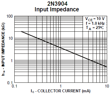

Because the intrinsic base resistance is multiplied by the current gain (Hfe) in the CE configuration to give a higher effective input impedance but it's not (amplified) in the CB configuration.
The datasheet for the 2N3904 has a graph of its typical common-emotter input impedance when its emitter is grounded or is bypassed to ground with a capacitor. Of course the biasing resistors are parallel to the input impedance.
The input impedance changes when the collector current changes:
This gives a good mathematical /graphical idea :)
