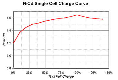

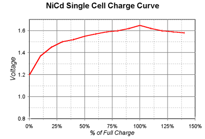

I think you are oversimplifying the linear regulator requirements.
In his circuit, the batteries need to charge to about 8.25V (see graph).
This is from https://www.electrodynam.com/rc/totm/totm1100.shtml
The series diodes require about 1V total. The current set resistor requires another 1.25V. The dropout voltage of the regulator is about 1.7V typical at 80mA. This means that the supply voltage must be at least 12.2V.
Hello there,
I have no problem with that. If he really needs 8v instead of 6v then clearly that 10v i quoted must be raised by at least 2 volts. I didnt know how many cells he was working with so i stated some general information.
