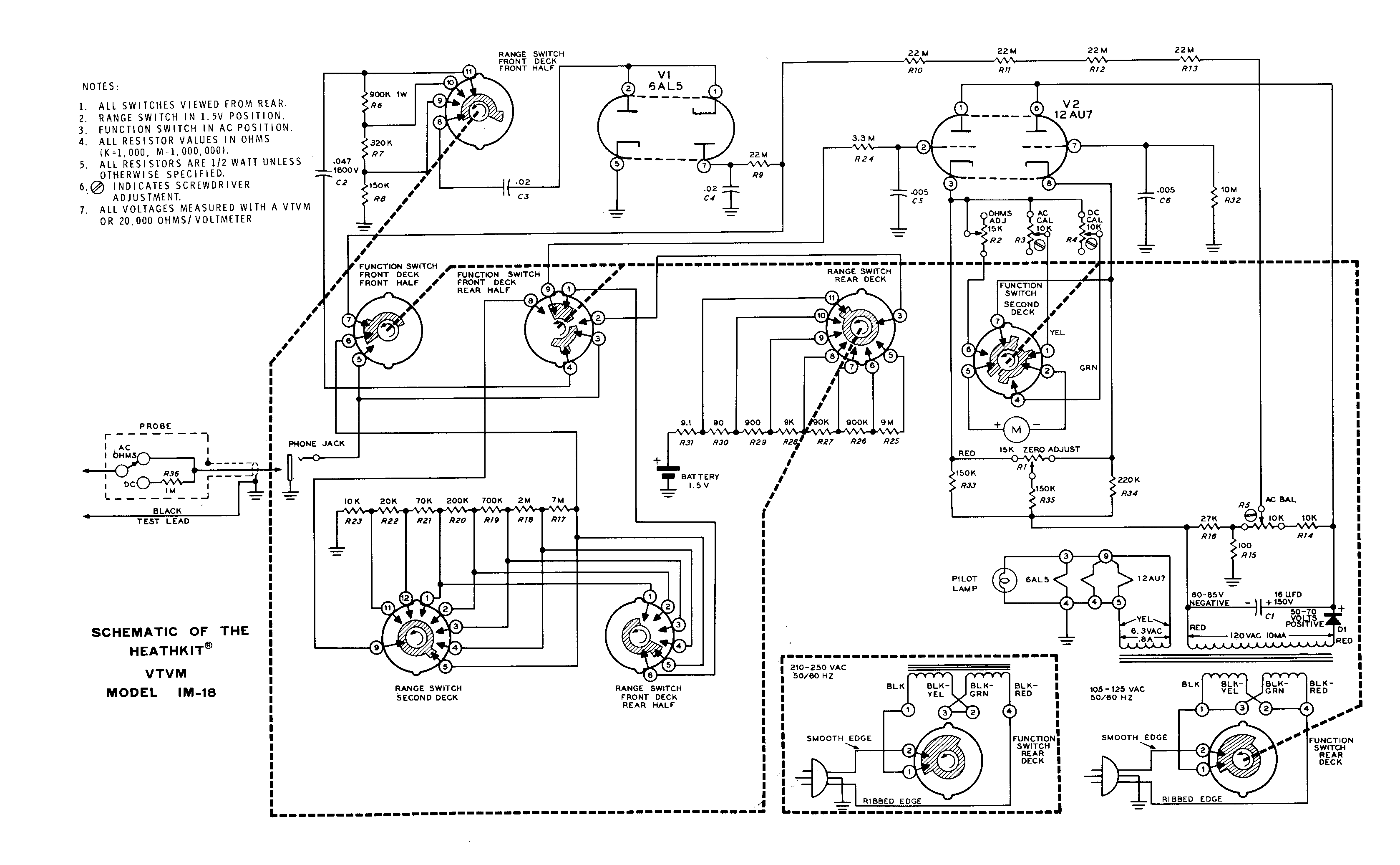

I have a VTVM that works but scale is way off. 12 volts dc reads 3 volts, 120 volts ac reads 20 volts, and resistance cannot even get meter to go to infinity or 0 when touching probes together. When turning unit on meter neadle deflect all the way to right then returns to left and you can get 0 adjustment on dc and ac, so what ever is wrong seems to be affecting all ranges and functions. My belief is that it must be a resistor between tube 12au7 and power supply any thought?

Have you checked that the power supply (-62Vdc, +60Vdc, and 6.3Vac) has the correct voltages?
Have you tried another 12AU7 in the circuit?
I would guess that the 1.5V battery is for the ohms range only.

Being a testing equipment, I don't expect the Valve to go weak so soon. In Valve based circuits, it is very common that HIGH MEG resistors give way. If you have a tester, better have a check and replace. I am suspecting the resistor deterioration around the V2. as resistor range also is not behaving.
By the way, as Kchriste has suggested, have a check of voltages. It is probable that you might be in 230V area and keeping the power switch in 120V range. Please ensure this. Even C1 can be replaced.

Have you tried changing the 12AU7 yet?
The symptoms point to one half of the valve being sick or dead rather than a resistor problem. You could also check the resistors and capacitors connected to the grids (R24, C5, R32, C6).

Start on the lowest + DC voltage scale and get that working. The multifunction switches make it look complicated. If you have a copy machine you can draw simplified circuits for each function. There might be just a single component that's changed value.
Maybe you should check the meter movement first. The full scale current is marked on the meter face. 50uA is 9v in series with 180k, 200 uA needs 45k.
I know meter is a 200uA and is ok. I have checked all resistor by using dc 1.5 volt dc range and 1.5 volt supply, then use dc calibration method which is the meter movemewnt is supposed to go all the way to the right side. Problem is meter needle will not even go half way. I already tried changing the resistor values higher and lower on pins 2 and 7 of 12AU7 tube and does not help. I am thinking of changing pot R1 to higher or lower value and resistor R33 to 100k maybe this will get more current flowing between pins 3 and 8 where the meter is connected. Once I get more difference between pin 3 and 8 it will work.
In principle, if you post your simplified schematic with all component values and DC voltage readings with the 1.5v input, if there is only one bad component it should be able to be found, and how far off it is, by inspection and calculation.

My tube measurents are with 1.5 volts dc applied to probe -2 volts pin 3 and a little more -2.1 pin 8 and the wiper of R1 has -4 volts which don't tell me anything. If I had good meter or if they gave you readings on schematic it might help. As you apply more dc voltage to input before 3.3 meg resistor voltages on pin 3 and 8 get less negative. Thing works good on until you apply voltage. I had to apply 10 volts dc to make meter show 1.5 volts. I have two meters same readings on both, 5 tubes same readings can't all be bad, power voltages all good, pins in socket all test good or the way they should, resistors test good with 1 volt don't have high voltage resistor tester. I was going to change resistors R33. R34. R35 but it seems like if I can balance meter to zero that part must be working. Probably just have throw it off a cliff.

I unhooked wire to 3.3 resistor where it enters pin 2 and put 10 meg resistor to ground so both triods are equal and it is really balanced good as meter is on 0 and pot is in center of rotation, then you put 3.3 resistor back and apply 1.5 volts dc hardly any reading almost seems like tube is not amplifing. Suppose there is no way of testing short of a tube tester or would instaling a 12AU7 in guitar amp which I have work as a tester?
