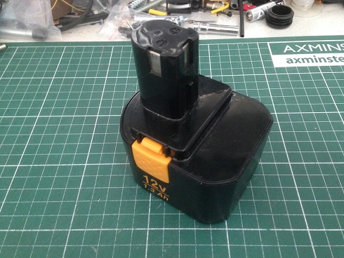

I had an almost identical project 18 months ago when replacing the battery packs for a collection of cordless drills I use. Although it's possible to make the 18650 fit the units with the correct voltage etc, I ran into some difficulties with the connections between battery packs and unit. You haven't stated which Jigsaw or shown an picture, but I presume the battery pack is the usual, similar to this .. ..
.. .. .. .. .. note the connector tabs at the top of the post; It is a small plastic plate with 3 spring 'tabs' slotted into it, but more especially held in place by one of the Nimh batteries; without that Nimh battery in place, I found it impossible to maintain the position of that plate to give a good connection, resulting in some arcing and the consequent heat.
I concluded that the best action was to replace the Nimh, batteries like for like, which I did successfully and the batteries continue to perform well.

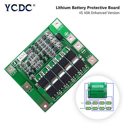

The BMS board is another matter; there are many variations with similar names, different functions and different ratings.
For one to work in this type of application, it must have both over/under voltage protection, adequate current rating to handle the tool motor stall current without damage - and have "balance" facility.
I'm using minimum 30A (peak)rated boards in power tools, 15 - 20A continuous.
Not all BMS boards have balance & without that, they disconnect the charge as soon as any one cell reaches the maximum voltage, leaving other cells part charged.
With balance, cells reaching near maximum voltage have a load applied across them, eg. taking 50 - 100mA, allowing the other cells in the pack to also be brought up to full charge.

the BMS boards I got are these, if you think I should get new ones happy to as I want the right one to protect everything.

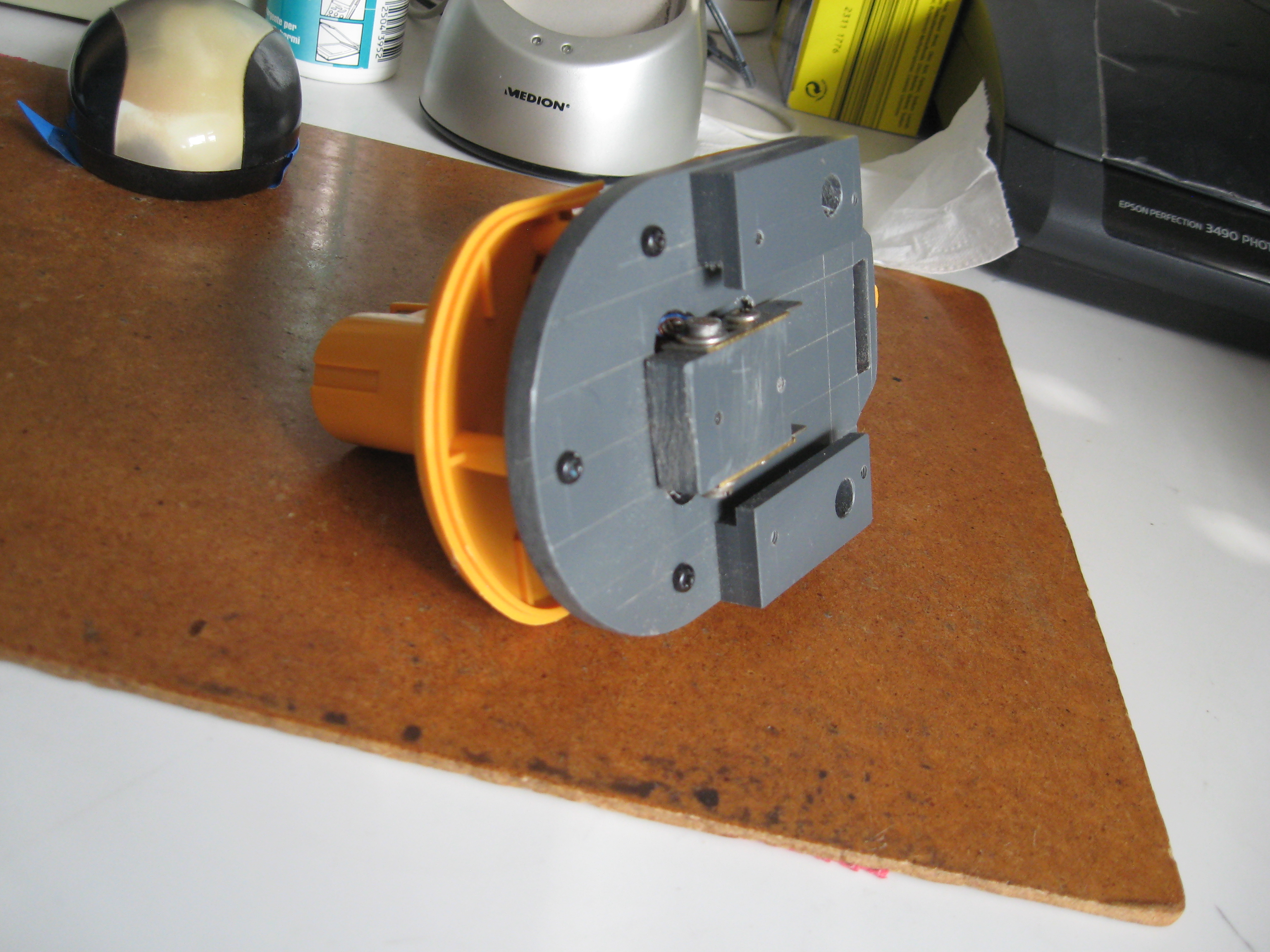

From time to time Lidl sell Li-Ion cordless tools and they also sell the battery packs and chargers separately. I bought some of these and managed to make an adapter (Using part of the old Ni-Cd battery pack.) to use these batteries with a Ryobi drill. This cost less than buying the individual cells and a suitable BMS module. This is a picture of the adapter.
Les.
Must say Les, clever idea! :D
Nice bit of 'thinking outside the box'.
yeah seen a few of these, but can never find the right adapter, never though of making my own tho .... gd thinking Les !!

The BMS I am using is this one https://www.ebay.co.uk/itm/4S-40A-1...e=STRK:MEBIDX:IT&_trksid=p2057872.m2749.l2649
Can you guys advise if this gives the over current protection along with the discharge protection ?
