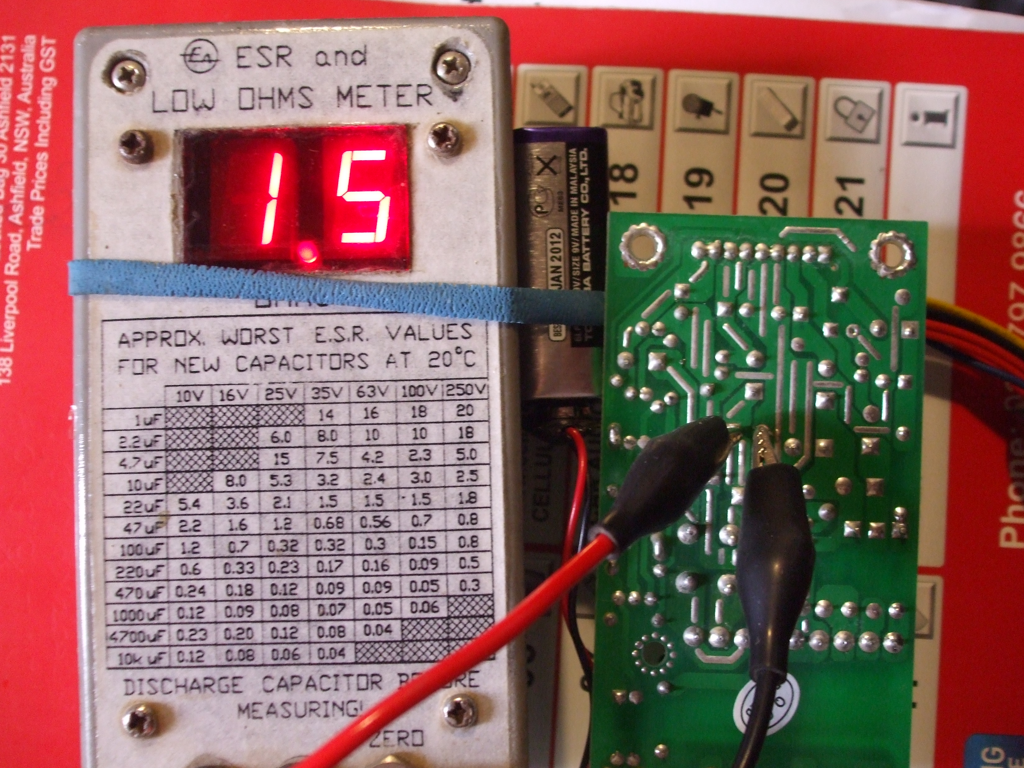

ESR meter only way to check caps quickly & easily in SWMPS. In circuit & discharged first. Ordinary cap testers & ohm meters are no good. Only other way is replace all caps.

The debate comes up often that capacitance testing does not accurately measure the effectiveness of the capacitor. The ESR meter measures the internal resistances at a given frequency. I specifically just repaired a SMPS circuit that was whining and would start and stop the load constantly. It turned out to be 2 small value caps that tested GOOD out of circuit with a cap meter but tested WAY out of spec with the ESR meter.

The picture i posted is a SMPS & capacitor testing in circuit & its faulty. Using this method is quick & easy.
