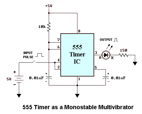

For my ideea, I was thinking - why use two 555s?
why not just have a non-retriggerable monostable, connected to a flashing LED?
this diag should help- just connect the flashing LED to the output.
Blaitently though, Stevez's idea is much better, and is much neater.
Stevez: you say, "if fast enough", LEDs take a while to light up, so it probably shouldn't be a problem, expecially considering the sped of modern logic ICs
In summary: use Stevez's idea, it much better.
P.S. can the circuit use the power from the 12v or not? if so, where is it coming from?

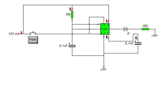

Well, I setup the following circuit in Crocodile Clips, and I can't get it to work. The reason I'm trying to make this circuit is so I can flash indicators on a car, and also sound the horn.
What am I doing wrong?
Well all I really need is a 12v pulsing circuit that only pulses twice then stops. Pulse length shouldn't be too long, maybe 1/10 of a second?

Explain what you think should be happening, step by step. I can see that you push a button - and that you have a series resistor in line with the LED. What do you think is going on in the 555?
Lets,
Your timing cap is way too small at 0.1nF (1us pulse). Even 0.1uF is way too small (1ms). Use 10uF for a 100ms pulse that you can actually see.
The 555 needs pin 2 (trigger), which should be high with a pull-up resistor, to go low to start the monostable.
Pin 4 (reset) should be tied to the positive supply.
Then each time the button is pressed, the LED will flash only once.
If you use this monostable to control the reset pin of a flashing astable oscillator, then the LED might flash twice, depending on your timing since they aren't syncronised, but the 1st flash will be longer than the 2nd.
Thanks for the advice, as I understand it I have to change the capacitor value. Any ideas how i would get it to flash twice.. its basically to simulate a car alarm so I'm open to any suggestions, as long as the circuit isn't going to cost me more than $40 to make.

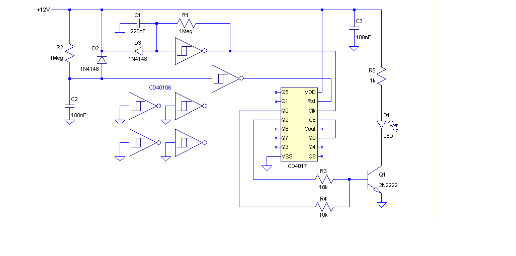

I think this will work, but I haven't actually tested it. Let us know how it works (or doesn't) if you decide to build it.
You can change the pulse width by changing R1 and/or C1. I show Q0 and Q2 as the outputs that activate the LED, but you can use any two outputs that are separated by at least one output, i.e, 1-3, 0-8, 5-7,2-6, etc. Don't use the output that feeds back to CE, as it locks up and stays high until the supply drops to zero. You can choose any output to connect to CE so long as it is greater than one that causes the second flash.
You can change the LED brightness by changing R5. Iled=(12-Vled)/R5.
