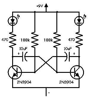

I have purchased loads of flashing dog collars over the Winter and they all disintegrate. Can I build something lightwiight yet tough that will illuminate my Jack Russels at night.

If it is the just the collar which is failing, use the electronics from the failed collar and build it into a good quality collar.
If it is the electronics which fail, yes there must be lots of things, but how much do you know about electronics?

Jack Russels jump. The G-force is too high for the electronics.

Hi there
Attached is a simple way to add flashing leds to your dog collar.
If the 9v battery is to heavy/bulky then a button cell can replace this although battery life will come into effect. A switch can be attached so it can be turned on/off manually.
Make sure that all wires are insulated and joins are heat shrinked to avoid damage.
If there are any problems please post them down and i will get back to you
Hope this helped
Spitso

One button cell won't power that circuit.
You'll need at least two, but it won't last for very long, but I'd use at least three, maybe four.

Use 2x of those 3V cells.
