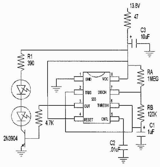

This circuit should produce the oculting light that you want:

Hmmm, I never thought of that. I actually had one lying around and I tried it. the flashing is the right timing, but the other LEDs don't go out all the way, they dim when the flasher is off, then brighten when the flashing LED blinks. It's not exactly what I expected, but it looks interesting, I may try that out, thanks for the idea.
well, looks like I'm going with K7's method. I tried out Russlk's diagram for shits n giggles and I jus ended up roasting that first 47ohm resistor. I really don't know enough about electronics to do this kinda stuff.
