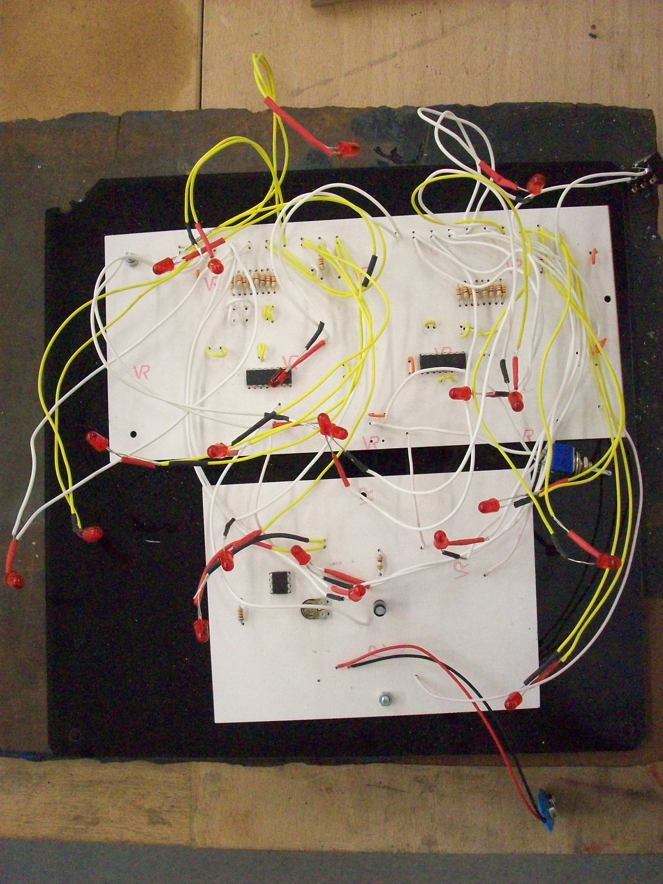

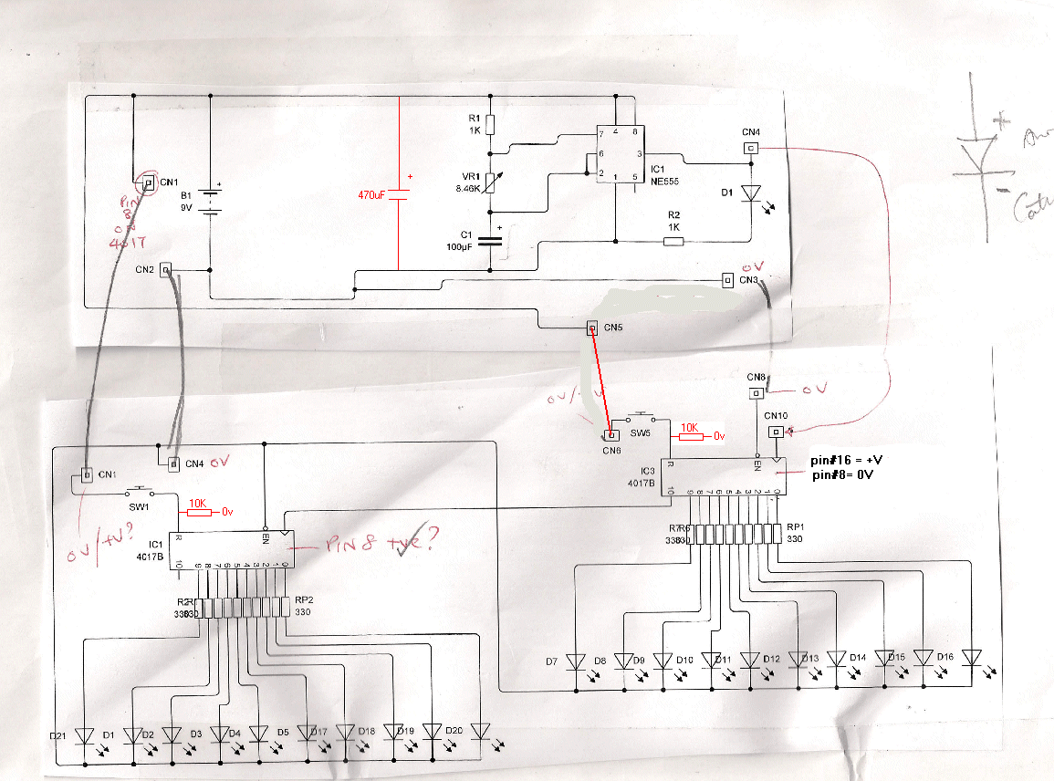

Hi all I happen to be a trainee teacher and I am totally new to electronics, over the past few months I worked on a small electronic project, which was all about connecting an IC 555 astable mode, with a double 4017. All I wanted to achieve was simply a motion light for a D/T secondary school toy project. The circuit was drawn using PCB wizard, which did a great job, but unfortunatley I would not know now how to explain this diagramm to a 12 year old, neither to my teachers, plus it doesn't even work.see attachments
I would not mind also just if any of you out there colud tell me in simple terms how this two circuits can be connected triggering the LEDS to light up in numerical order.

The first obvious point is that pins 15 [MReset] of the 4017's are floating when the RESET p/b is not pressed.
This could cause mis-operation.
What symptoms does the project show.??

You should look at the datasheet of the CD4017 to see the power supply pins.
Pin8 is 0V and pin16 is +ve.
The R pin15 of each CD4017 should have a 10k resistor to 0V.
The battery should have a 100uF bypass capacitor in parallel with it.
I didn't check the pcb nor the maze of wires all over the place.

hi veste,
If there has been the possibility that the voltage rails have been crossed over the 4017's will most likely be 'dead'.
The 4017 power pins are pin16 is +V and pin8 is 0V, check the pcb copper track to ensure that is how they are wired.
Add the two 10k's on the MR pins of the 4017 also a 470uF cap across the +V and 0V rails,,, as shown in the edited dwg.

I think you should neaten up your practical work before you start teaching electronics. Make the board smaller, mount the resistors neatly and flat on the board and get rid of those flying leads and solder the LEDs directly to the board.
You might think I'm being picky but many errors can result from sloppy construction rather than bad circuit design. When you get to do more skilled projects which involve high frequencies low currents or high impedances neat and compact construction becomes mandatory.
Hi veste,
how about that circuit design?
It drives 24 LEDs from three cascaded decimal counters (HCF4017) and includes driver transistor arrays for highest possible LED brightness.
The board size is determined by the number and diameter of the LEDs. (Used: 24LEDs at 5mm diameter)
Board size: 6.3X1.9"
Clock frequency can be varied from 27 to 110Hz.
I agree with hero999 considering circuit construction. There are too many wires with the possiblity of faulty connections, resulting probably in fried IC's instead of a functioning circuit.
The attached circuit has not been tested yet, but the simulation is right.
