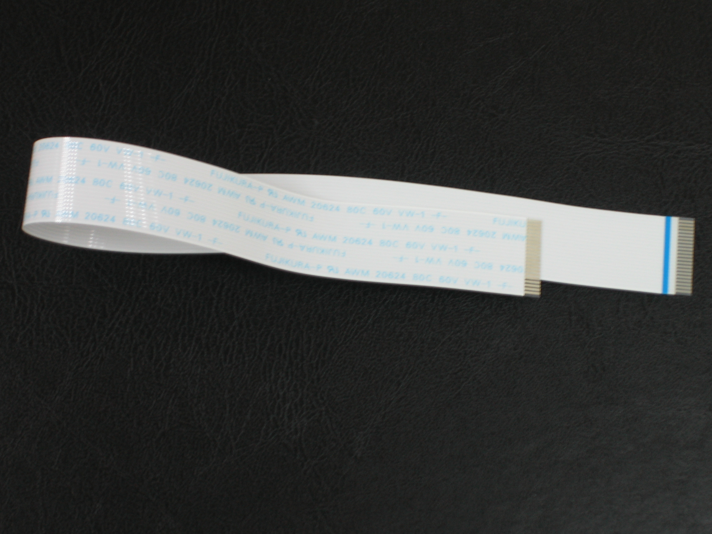

Can anyone suggest any methods to remove the insulator from flat ribbon cables? I have a modest collection of the stuff that I want to try a few things with but I have no idea how to go about getting to the copper on the ends (the contact ends have been cut off on most of them)
Any suggestions? Linked bellow is an image of the type of ribbon cable I'm talking about.

You can separate each wire slightly from the bundle and use a wire stripper.
You're thinking of a different kind of ribbon cable crut, this stuff isn't wire, it's flat almost like a PCB trace only on a flexible substrate, regular wire strippers don't work. The insulator seems bound to the conductor somehow not just surrounding it like regular insulated wire.
Guess you should better define 'strip' in this case. Never tried it, but worth a shot... Acetone melts some plastics, so you might try some masking tape to protect the insulation you want to keep, maybe a towel or rag slightly damp with acetone. If the plastic softens, just scrape it off. Chemicals don't work, there is always fire...
I was trying to avoid the chemical methods, but I have access to harder acids and what not, would just be a pain. I was thinking of pressing the main part of the cable between two pieces of aluminum and torching the insulation off but that's not much neater or cleaner than a chemical removal. I'll have to play around with it.
Yes, I didn't look closely at your picture.
I think the hot (nichrome) wire approach suggested by BrownOut would have the best chance of working.

After I downloaded your image and magnified it I came to the conclusion that the "ribbon cable" is sort of conductive material embedded in foil as used for printer heads.
The tweezers work only well with "real" wires.
Not just printer heads, this stuff is everything, CDROMs AV/equipment laptops, any generally compact device.
I just stripped my 16-pin flat ribbon cable with pure acetone...soaked the end of the ribbon for a few minutes (in a tiny closed container, so it doesn't evaporate), and voila!! Now I have to figure out how to solder it back to the motherboard...Any suggestions...
