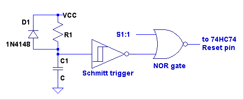

This is my problem. I have to apply logic 1 all the time, but I need logic 0 on power-up at the output pin. I think I need some kind of logic here. The chip is 74HC74, which has asynchronous set and reset ability.

To force the Q output low on power up, use the circuit below. The R1*C1 time constant depends on your power supply turn-on rise time, but 10ms - 100ms should be OK.
