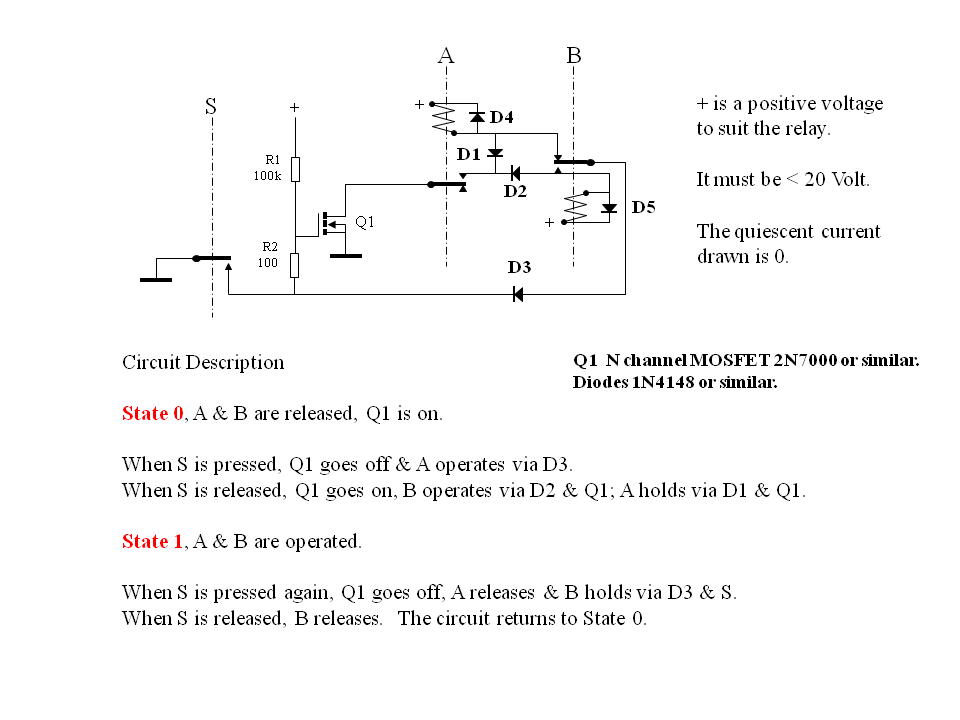

You could use a relay toggle circuit.
You will need either a relay of a TRIAC to switch the lamp anyway.
Either relay can be used to switch the lamp. Use a DPDT relay so the second contact is used for the lamp.
However, note that the relay operate & release times must be less that the contact bounce time.
See attachment.
