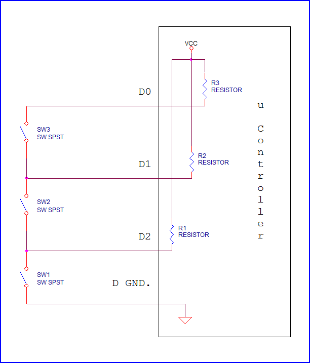

I don't get it. You have a float switch but even though you linked to them you don't mention which version in the link you have? One single point switch? Four switches? Which one?
Even with a float switch if it only contains a single switch they come in SPST and SPDT so again, which switch?
Best case with a single switch you can tell if the tank is at some point and that is as good as it gets. If for example you have a 400 liter tank that is linear and the switch is 1/4 up from the bottom we can assume when the switch changes states the tank will have about 100 liters remaining. That is as good as it gets.
So the uC input will see a 1 or a 0 (high or a low). If the switch closes at 1/4 tank your code should pick up the transition from high to low on a pin designated as a DI pin. You do not need a switch to check your code. Place a logic low on the DI pin and the code should respond. That would be the code you don't want to post. If you think you have a uC problem there is a section of these forums dedicated to micro controllers.
Without seeing the code, a schematic and knowing the exact switch that is as good as it gets.

hello ron...float switch has three wires to indicate each level of fuel low,mid or high every time fuel reaches a particular level particular wire gives out 5v and some 0.5amps current so we built the circuit to reduce the current since our micro controller can take only max of 20ma so...in our current reduction circuit just ttl logic 7408 and in series with a 560 ohms resistor that gave us some 8ma output current so we were happy to connect it to board but when we connect it the atmega32 board is driving the voltage i dont know why??????????what can be the best solution please reply...as quickly as possible
OK, now we are getting somewhere. This also makes sense. Well, almost sense. When the pins of the uC are programmed as a DO (Digital Out) they can sink or source a limited amount of current and I believe that is where you came up with the 20 mA.
You mentioned that the switches have 3 wires? If you have levels of low, mid and high the switch should have 4 wires total? The 5 volts is coming from somewhere? If I apply 5 volts to the switch common then I can understand the 5 volts but there would be a 4th wire as the 5 volts is coming from somewhere?
You mention the uC has internal pull up correct? That tells me if you configure the pins for DI (Digital In) the pins will float at between 3.3 and 5 volts depending on the uC. Placing a low on any of those pins will produce results. But ..... Let me maks a drawing to explain this. Back soon.
OK attached is a very rough sketch of a uC using digital inputs driven by switches. The resistors drawn in the uC are the internal pull up resistors. The uC is programmed so the Digital In/Out pins D0, D1 and D2 are Inputs. I just used simple switches that are NO (Normally Open but when the tank is full they are all closed. The switches in my example likely could have been drawn better. Since when the tank is full all switches are closed as the tank level decreases the switches will sequentially open top to bottom.
Switch 3 will open and D0 will go high and the code for that D0 pin would look something like:

Something along those lines is where I think you should be going. This is based on your mention about the internal pull up resistors. The DIO pins should be programmed as DI.
The attached was done in haste so I hope you get the idea.
Ron

yes sir exactly you got it ..we have four wires one for common and three for indication....yeah this is the way it is connected to uc but our uc is not responding instead it driving voltage from the switch connection...
As i had said earlier for best results the switches need to have negative wired to them not 5v+ as you have said you have, the reason is you have "pullup" resistors and not pulldown as you would require for 5v+ to the switches.
As Ron said the micro only sees 1's and 0's and with 5v+ to the switches than it will only ever see 1's and never 0's so you will not get a change in state on the input.
Secondly having a ground supply to the switches if far safer than having 5v+ supply when you concider it is a fuel tank.
I dont see what you are requiring limiting resistors for as its just a simple pull low with the switches and pulled high with the pullups circuit, so the most current that will be drawn is via the pullups.

Rather than posting your entire code and expect someone to filter through lines of code, why dont you just go back to basics and try to read a single switch in code and get that part sorted out first.
What i would normally do is use a basic code to read the switch and light a led, once you have that part working then its easy to add it to the main program.
The whole thing with programming is to do each step at a time and get it to work then advance to the next stage, then it becomes easy to string it all together.
Pete.
Glad it worked for you.
Ron
The best way to look at your problem you had is 2 high's dont make a low.
Ie: high on the pullup resistors and a high on the signal in, can only ever give you a high on the input pin, it is never pulled low so the micro will only ever see a high input.
Using ground through the float switches will pull each input pin low as the switch is activated.
Good to see you have the circuit working but if you had followed my advice from around the first post you would have solved the problem days ago.
We live and learn so good luck with your project.
Pete. (not sir???)
