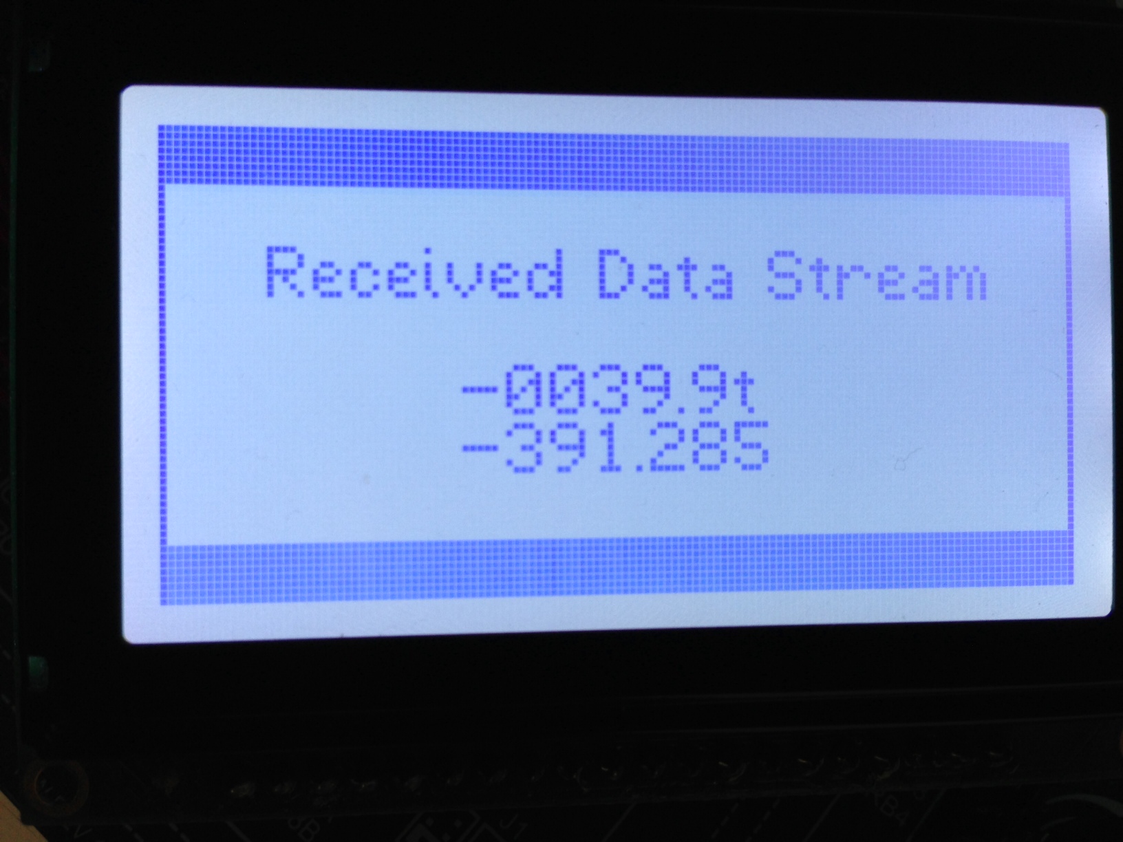

The first line is the whole string
The second line is in the kN.
It does work but to make it work I have to reset two to three time (using MCLR).
Cheers

You mean the GLCD doesn't work first time??? I'm having that issue as well at the moment... Its a T6963C but I have to reset more than three times before it runs...
I'm looking into it as we speak...
Many Thanks Ian for your time.
GLCD doesn't work first time. Need to reset many time to get it work. Once it starts, GLCD works fine
Cheers

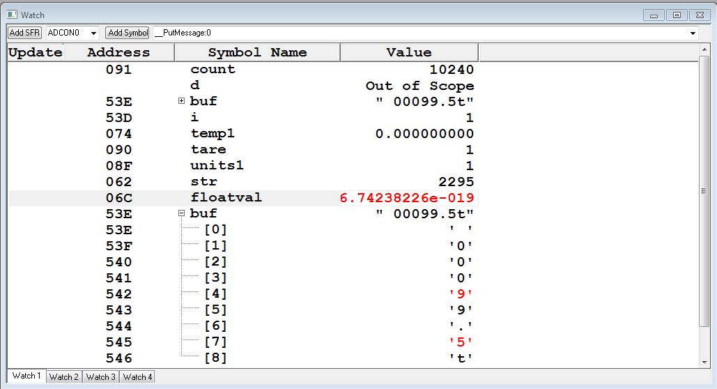

Hi Ian,
If I am not wrong the pointer does not allocated any memory for buffers:
char* str;
This is just a pointer which point somewhere in the memory. I am trying to define this way so that actual memory is allocated.
char new[20]; /* Storage for 20 characters */
str=new;
What do you reckon. Does it help ?
Cheers
If you increment your pointer like this there is no way to come back to the start of the string. Use proper indexing like I showed you in the other thread.

I assumed that the code is called periodically. Incrementing a pointer works fine only if you do it one time..
Thanks Ian and misterT for your valuable response
@misterT as you quoted post#10 gives me an error. Because the function for float ASCII conversion is as below :
void ftoa(float value, char *string)
     if (value < 0) {
         *string++ = '-';
         value = -value;
	sprintf(string, (const far rom char *) "%lu.%02u",
                     (long) value,
                     (int) ((value - (long) value) * 100. + 0.5));
Cheers
Hi misterT
Got it working. You were correct except this
char str[20]; //
ftoa(mod,str);	// Float to ASCII conversion
for (i=0; i < 20; i++) // Print on the GLCD // Put String on GLCD
			PutChar(str[i]);
