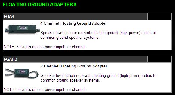

I'm currently installing a new stereo system in a 1987 Ford Mecury Cougar XR-7. The After Market harness hooks up to the OEM Harness. The Only problem is the ground wire for the AfterMarket Harness goes to a spot on the OEM with no wires going to it!
The Harness documentation saids: That I need a "FGA" Floating Ground Adapter.
Whats a floating ground compared to a common ground? And could I just run the ground to the regular car's ground point?
It was fairly common for radios in older cars and some new ones to pick up their only ground from a chassis connection between the radio chassis and the car chassis, usually via a mounting stud on the back of the radio. I've seen quite a few that did not have a ground wire in the harness. I would think that it should work just fine to ground the stereo chassis to the car chassis. But it is also possible that the new stereo has an isolated setup of some sort. In this case I don't see why you can't splice into the ground wire on your new equipment harness and hook that up to vehicle chassis.
Instead of guessing, you might as well lookup Floating Ground Adater in Google.
It has transformers that are too small or resistors that strangle the power so that a new car amplifier with bridged amplifiers can connect to exising speakers wired with one wire from each speaker connected in common and to ground.
They can also be used to convert balanced bridged amplifier outputs to unbalanced (one wire grounded) amplifier inputs.

Thanks guys. The Stereo works fine with just the regular chassis ground. I don't need a FGA for my current application
from what i feel ... it will blow soon. Most, see all newer car Stereo system use Balanced output (bridge BTL amplifier like TDA7386 and Pals) and most of them will blow after few minutes/hours of use. You really should consider to route new wire from the radio to the speaker. The floating ground adapter is still an option but you will loss a big deal in the sound quality and power.
