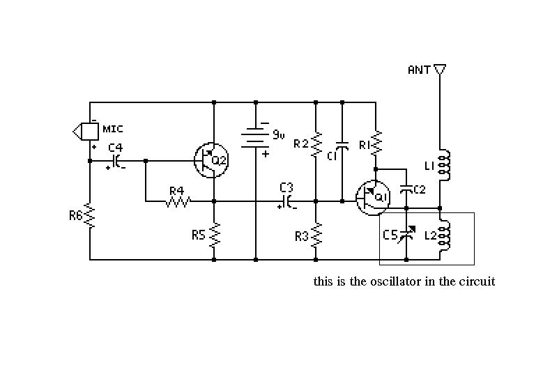

I have build the FM circuit posted at: FM Transmitter
Can some one tell me which part is oscillator and which part is frequency modulator? I am confused.
I would appreciate if some can tell me detailed working of the circuit.
Is it possible to make a high frequency (100 Mhz) oscillator using IC's?
the frequency modulator is C5 in the circuit. the oscillator is the tank circuit and the frequency output is determined by the equation: F= 1÷2 Pi √LC

Q1 and it's assciated components form both the oscillator and modulator. It will oscillate at the fundamental frequency, but changes in the capacitance of Q1 due to the input from amplifier Q2 vary the osllation frequency for FM modulation. C5 is a fixed value capacitor, and does not change the frequency. Here is a pretty good article https://www.members.tripod.com/~transmitters/begin.htm
