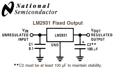

I used a low-dropout regulator that MUST HAVE a 100uF output capacitor. Yours don't have a regulator so their frequency changes as the battery voltage runs down, mine doesn't.
It uses a half-wavelength antenna like most FM car radios use.
Its range is illegally very far. I gave up walking and took my car 2km away and it was still heard across a huge river valley even though a low power foreign language radio station was on the same frequency. All FM station frequencies are used in my area.
audioguru
Read the whole data sheet:
http://www.datasheetcatalog.org/datasheet/nationalsemiconductor/DS005254.PDF
Another regulator characteristic that is noteworthy is that
stability decreases with higher output currents. This sensible
fact has important connotations. In many applications, the
LM2931 is operated at only a few milliamps of output cur-
rent or less. In such a circuit, the output capacitor can be
further reduced in value. As a rough estimation, a circuit that
is required to deliver a maximum of 10 mA of output current
from the regulator would need an output capacitor of only
half the value compared to the same regulator required to
deliver the full output current of 100 mA. If the example of
the capacitor in the circuit rated at 25C junction
temperature and above were continued to include a maxi-
mum of 10 mA of output current, then the 22 uF output
capacitor could be reduced to only 10 uF.

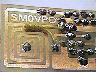

you can set the frequency of transmission, it has a gimmick capacitor added across the 12p tuning capacitor .
Here's the image
