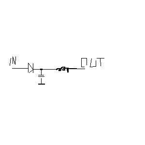

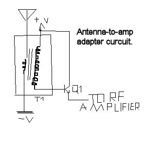

After all those superhets, superregens and stuff I decided to take a new turn. I decided to go with a simple crystal or ceramic tuner to select the specific range of freqencies, and the simplest possible detector. I also want some guidance about the rf and audio amplifiers as well as the rest. And i dont care about no static or state-of-the-art quality.

What is a "ceramic tuner"? Never heard of it.
If you are trying to receive FM, a crystal set WILL NOT WORK.
Also be aware that when used to receive AM, a crystal set has very poor selectivity and sensitivity. You will need a long antenna to receive anything at all, and then if you are lucky you will receive several stations at the same time. The single coil just does not have enough "Q" to give reasonable selectivity.
Your crystal set won't work. :D
The tank-oscillator circuit was splited by the transistor and the diode (crystal) there.
First you need to parallel the oscillator coil with the capacitor (LC), forming a oscillation circuit, then you make the detector.

I think you should read a few books on the subject and you will soon realise what most of the people are saying. F.M. needs a stable Frequency source since the intelligence in the signal is in the amount of shift from the centre frequency. So a receiver needs a very stable oscillator like a Phase Locked Loop (PLL) good front end design and a well laid out discriminator.

Never heard of such a thing?, a 'crystal set' is (these days) a simple tuned circuit followed by a germanium diode detector, it's AM only, requires a huge outdoor aerial, and only receives close strong signals. Originally it used a tuned circuit and a piece of 'crystal', which was galena (not sure about the spelling?), and you used a 'cats whisker' (fine springy wire) to locate a sensitive spot on the crystal.
Presumably your radio is a superhet with a PLL synthesiser?, which uses a quartz crystal as the reference frequency - however, in no way could it be called a 'crystal' radio. As for 'ceramic radio', again theres no such thing!.

But his drawing shows some sort of galena radio.
