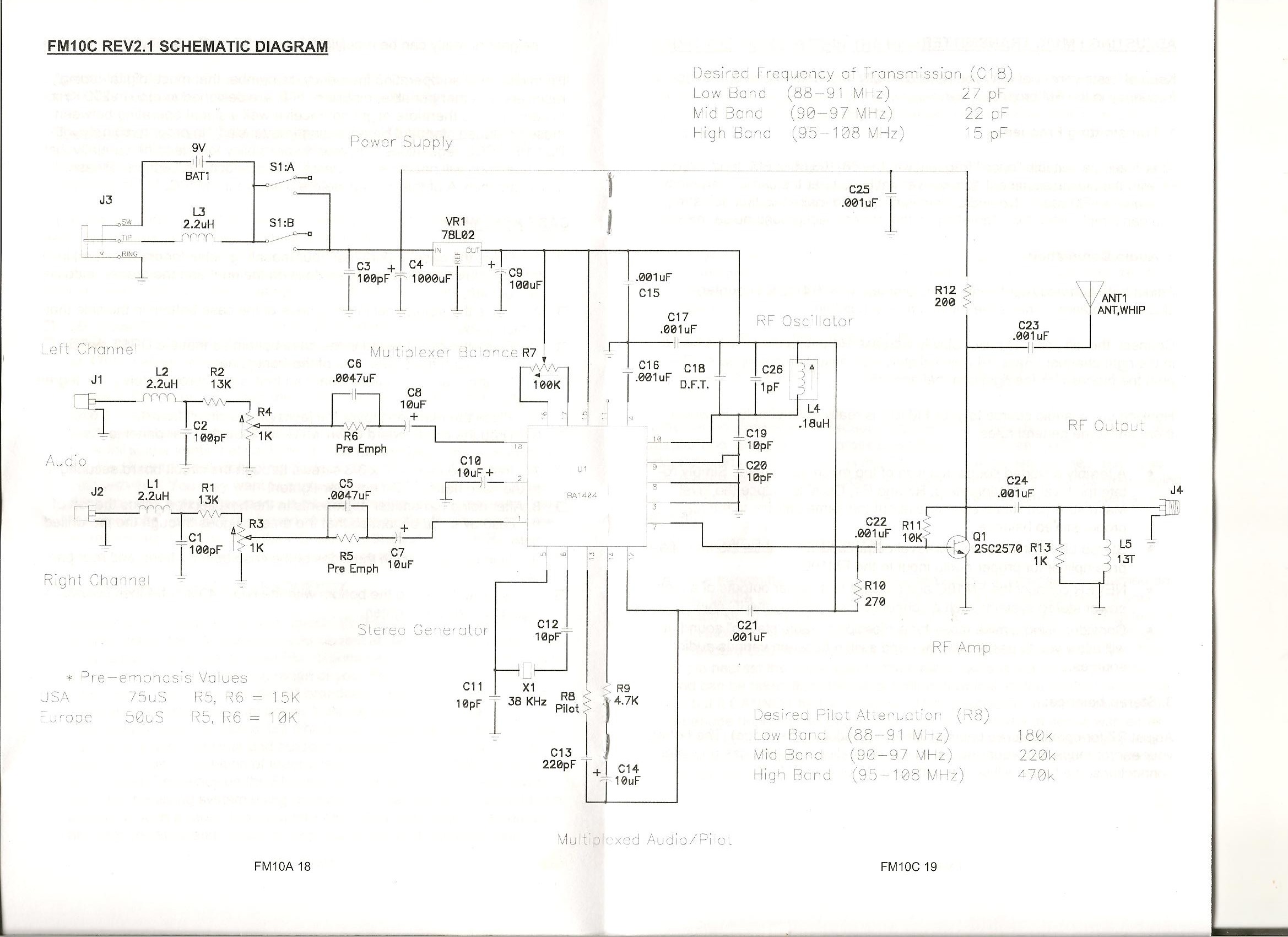

I bought and assembled a fm transmitter kit and it works good but i was wondering if it could extend its range. could removing R12 help?
You must not remove R12.
It takes a lot of power to get a high wattage transistor working, like the one you have. You should get 5km with the circuit.
I get 3km with 2N3563.

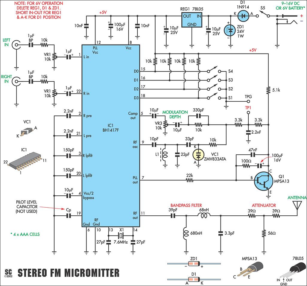

The BA1404 IC is obsolete and has not been made for about 7 years because it had many complaints of poor performance. So its manufacturer Rohm released a few much better ICs that use a programmable RF frequency synthesizer using a crystal oscillator and a phase-locked-loop.
The Micromitter is a project that uses one of the new ICs and the circuit is used in a kit and in most MP3 to car radio FM stereo transmitter products. It has an attenuator at its RF output to produce legal short range.
