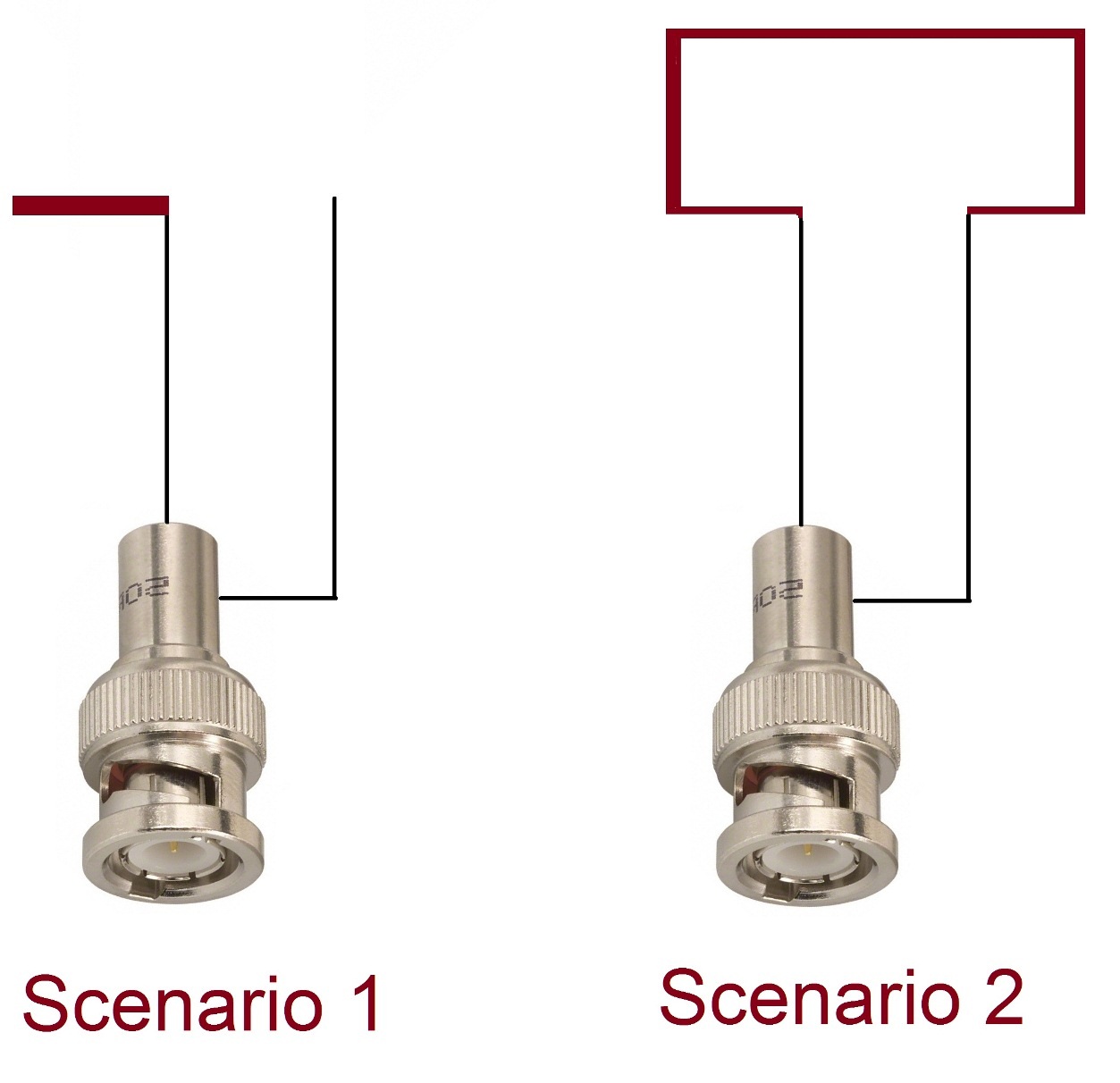

Antennas will not read at DC the same as at the frequency they are built to work at (AC). Your ohm meter measures at DC. It may read near 0 or near open. Will not read 50 ohms.
Oh yeah you are right. Impedance is a function of frequency. But, what does it depend on while on DC? Zero and open are the two extremes you know. If you remember the FM antenna in my other thread, that didn't beep, so it was either open loop or it had some DC resistance.
Antenna 1. A wire goes to the left and ends. A wire goes to the right and ends. OPEN
Antenna 1. A loop of wire that at DC is a short. SHORT
Something like this:
I've drawn the two cases you explained. So, is that right? I'm interested in knowing where does the two leads actually connects/ends. Something is off in the photo I attached I know.

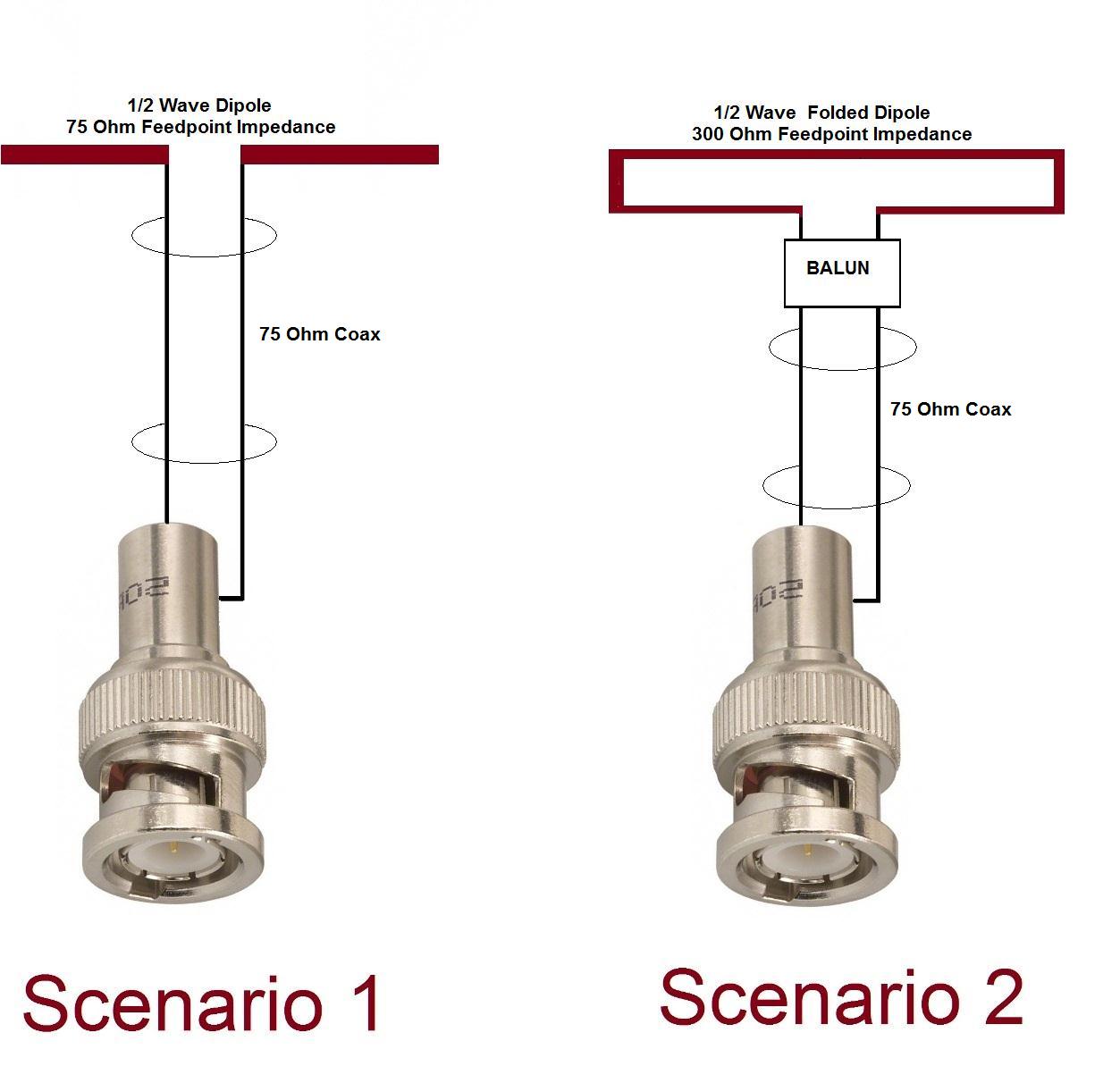

ok just completed your drawings for you :)
should make it a little clearer
cheers
Dave
Thanks man. But, it will be great to add an explanation to what you have drawn.
haha ok but not too much else to tell wonder if there was something specific that you would like me to address ?
They are the 2 standard types of dipoles. Both can be used stand alone as you see them or they can be incoprorated into a yagi antenna with a reflector element and any number of director elements.
When in stand alone use the 2 dipoles have the feedpoint impedances as I have shown on the diagram.
When they are incorporated into a yagi system their impedance will drop... the 75 Ohm dipole can drop as low as 25 Ohms, the folded dipole can drop from 300 Ohms down as low as 200 Ohms.
This actually makes the folded dipole very popular for yagi users as its quite easy to make a 4 : 1 BALUN to match the 200 Ohm feedpoint to 50 Ohm coax cable. A number of my yagi antennas have used this method over the years. You will find that many users of the plain 75 Ohm dipole will use 50 Ohm coax to feed it. The resulting mismatch and return loss isnt really a problem. say for a good match of a near 1 : 1 SWR ( near 0W reflected power) when using a 75 Ohm feed point, cable and transmitter. Using a 50 Ohm transmitter and cable to a 75 Ohm feedpoint may result in a ~ 1.2 - 1.3 : 1 SWR. Thats no major problem unless using very hi power transmitters say greater than 500 W where you could end up with several watts of reflected power.
Even then circulators in the transmission line will take care of that reflected power by dumping it to a dummy load and the transmitter will never see it at its output port.
cheers
Dave
