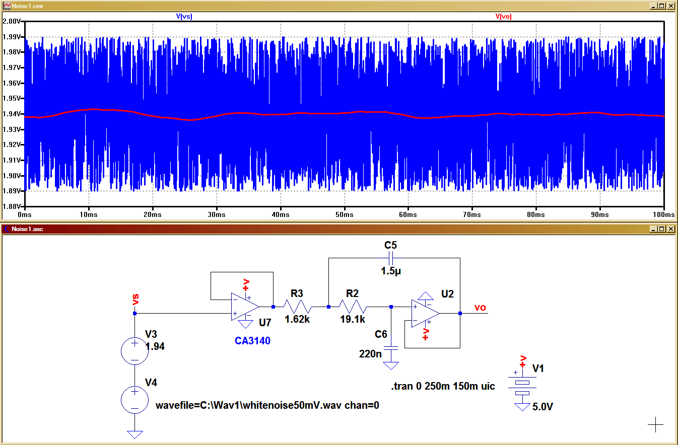

I understand. I'm just making it in a simulator first and I was wondering if there were any just... General procedures to cutting noise?
Thanks for your help though. :)
If you're just simulating it then what are you using to model the noise source?
alec,
These 'noise' samples I created using Audacity Beta (Unicode) free download ,includes a simple demo asc with filter.
The Audacity program is also useful for ring tones and Chirps if you are interested.:D

Thanks, Eric. I was just wondering what the OP was using and would have suggested something similar. I've been using Audacity for a couple of years and suggested it a while back as a white/pink noise source to someone experimenting with FIR filters.
