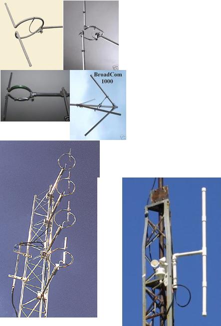

I have never seen your type of antenna before. In broadcast. I question the antenna spacing.
See pictures: I have something like the left pictures. (H+V) I have never used the BroadCom antenna. The bottom Right picture is from Ramse and V only. In all these cases I use 1 through 12 antennas mounted vertically like in picture bottom left. Care is taken so the antennas are fed with the same length of wire or so the wire is 1 wavelength different. These antennas are built to send power N.S.E.W. with the same power. They have a very tight pattern vertically. (up/down) There is no need to send power into space and it is a bad idea to send power down into ground.
I can see you have a pole not a tower so you cannot put a big antenna up. My smallest station had only one loop like the left center picture.

I perfectly understand your comments about polarization. But the mounting brackets that came with the each of the 4 antenna suggested the polarization you see. The brackets are something like this:
Uploaded with ImageShack.us
I can only mount them vertically if I have a horizontal pole up there. But then again, it will be omni directional. So why did they sell them 4 antennas? And will it make sense to mount all 4 vertically ?
I think I will have to ask the guy they bought this stuff from. I hope he is knowledgeable though, not only sells stuff for money.
