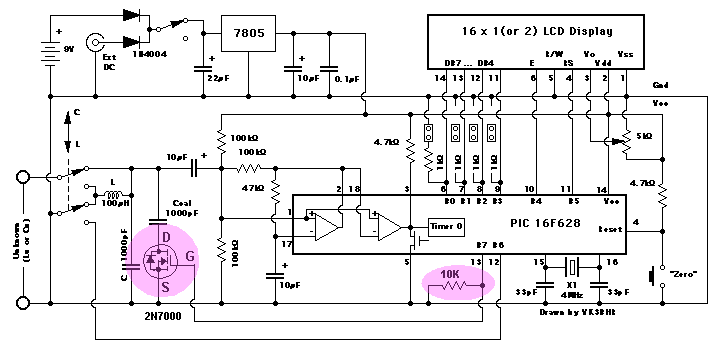

I'm engaged in building this LC meter.....
But the 5V reed relay which is a low current type <30mA is nt easily available here...I think I've to get it from farnell india..........
But I think a 2N7000 moisfet can be used for the switching...can somebody tell me how to connect it....
You could use the pin that drives the reed coil to drive a 2N7000 gate and connect a standard relay in the drain circuit.
According to the FAQs by the designer, a 2N7000 mosfet can be used to switch the 1000PF capacitor. Here how it is connected:
Nice info and thanks eblc1388, but it did not yield proper result when i tried last week. After this info, I would like to give another trial.

Mine shows overrange after calibration screen.......can you find some possible causes::
and, my poor meter have a 450uH inductor in place of 82~100uH....which simply can't generate the expected tank oscillation frequency.....will changing it blow the overrange error away?
I've no 5V relay...but i'm looking about to buy a such from farnell.in .....I've connected a 2N7000 as me friend eblc showed...i think it's corrcet...
450uH is far too high perhaps. 100uH &5V relay are generally available.
There are single line and DIP relays made by either OEN or PLA. One can retrieve a relay from any dial up modem cards. we may use a drive transistor and directly use 12V instead of 5V regulated by 78L05.
perhaps , no need to resort to Farnel.in
