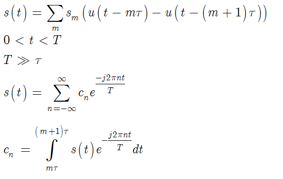

Hey all,
I've been working on computing the fourier series of the problem I posted below. It shouldn't be difficult but I keep getting the incorrect answer. Take a look at it and tell me what you think.
The thing is I don't actually care about representing my signal as a fourier series, I just care about the cn frequency samples, I need an accurate representation of the frequency spectrum, and an FFT doesn't do the job I need.
However, if the fourier coefficients are correct, then my time domain fourier series should obviously be correct as well.
Edit: I've done this problem at least 4 different times and I keep getting a different and incorrect answer.

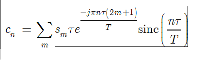

5th time is the charm I suppose. I got the correct answer.
Here is the solution if anyone is interested.
Thanks anyway.
