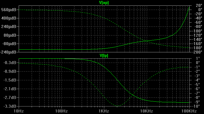

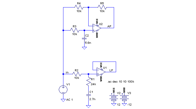

If I understand correctly, this should do what you want. If you want to use a single supply, the circuit can be modified.

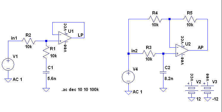

As per your PM request (-3dB shelf on filter), here is the .ASC file, along with modified schematic and Bode plot.
