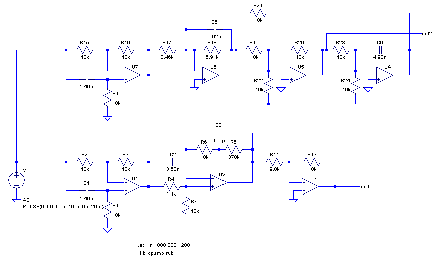

I'm currently trying to build an analog circuit that will phase shift sine waves of various frequency (from 900Hz to 1100Hz) in a very specific way. What I'm trying to achieve is a constant time delay at the output (in respect to the input) of the circuit without modifying the amplitude of the sine waves. More specifically, here's what I want:
Input/Output:
- Waveform: Sine Wave
- Voltage: 0.1V - 5V
- Frequency: 900Hz - 1100Hz
Output:
- Time Delay: 0.25ms
The time delay of 0.25ms suggests a phase shift of:
- 81 deg for 900Hz
- 90 deg for 1000Hz
- 99 deg for 1100Hz
I've talked with many profs in my department about this, but unfortunatly since I'm a physics student, none of them has a lot of experience in electronics. Fortunatly, I found this forum and I know at least one of you is smart enough to help me with what I want...
Any design ideas or schematics would be greatly appreciated...

An Allpass filter will provide the phase shift required, without changing the amplitude.

Your lowpass filter will reduce the amplitude at 1100Hz more than at 900Hz. The requirement is: "without modifying the amplitude" which can be done by the allpass filter I recommended.
Thanks audioguru... at first glance, I think this is exactly what I need.
Unfortunately, I can't really elaborate on what I'm doing due to the complexity and the nature of my research. What I can tell you though is that the system consists of a waveform generator which will generate a signal of 0.1v to 5v at a frequency of 900Hz to 1100Hz (remotely controlled) at the source of the circuit, and we need a constant time delay (0.25ms) in respect to the generated signal at the output without distorting the signal. This means that I need a circuit which has a flat response, so the simple RC low pass filter will not work. I’m also aware that I can use two remotely controlled generators to achieve the same results. Even though we have the resources to do so, for a specific reason, this setup cannot be used.

As Audioguru said, you can use an allpass network. You could possibly do this more easily digitally (A/D, delay, D/A) but I'm basically an analog guy, so I did a little research...
I found a program called **broken link removed**. I downloaded it, and by playing around a little, I got it to give me seven different implementations of the same transfer function, which does what you want... except for one thing. For some reason, some of the implementations have inverted outputs.

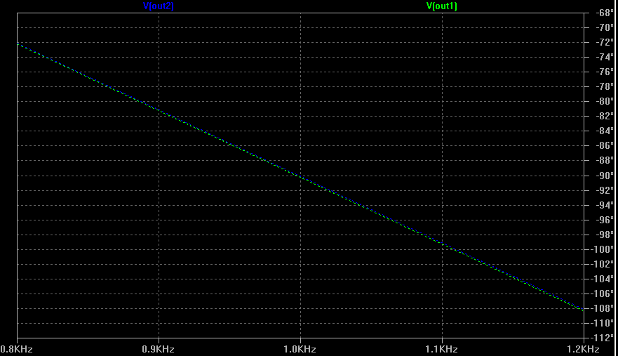

Filter free will give you frequency response and schematics. To satisfy my own curiosity, I have redrawn and simulated two of the implementations (below), with a plot of their respective phase plots. I got rid of the inverting output stage that the program had added to the upper circuit.
The upper circuit (out2) has slightly flatter amplitude response. Out1 has about 0.2dB dip around 1kHz. This may be because I rounded the component values to 2 places past the decimal.
If you have any design or analysis experience, I encourage you to play with Filter Free. It's pretty cool. :)
BTW, these circuits will give you 250usec delay from DC 1.1kHz, and out to a couple of KHz, depending on how much delay variation you can tolerate.
PS I want to make it clear that the schematic below contains two separate circuits that do the same thing.
