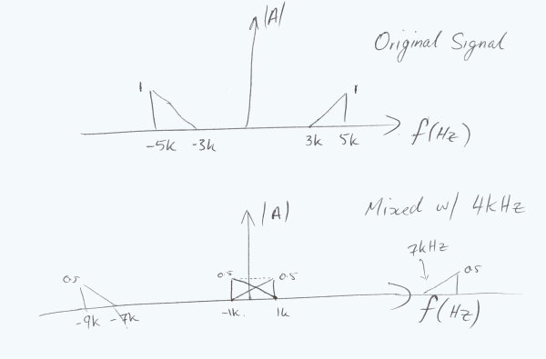

No, analog frequency is theoretically simple - just mix it with a sinewave and you'll create a new frequency spectrum; e.g. if y is the input frequency & x is the mix freq, you get 2 resulting frequencies: x+y & x-y (due to the trig identity: sin(x)sin(y) = 0.5(cos(x-y)-cos(x+y)) ). The problem is that to make it useful, you have to filter out the unwanted frequencies from the initial spectrum before mixing, and you may need to filter again after the mixer. The mixer can be a simple squarewave mixer (will introduce odd harmonics though) using a 555, an inverting amp and a analog MUX selecting between the inverted and noninverted signal at the rate of the mixing frequency.

A crossover is a filter, but I'm guessing it's only 1st or 2nd order? This may not be a problem for you if you're not too particular about which frequencies are in the the output signal. You can simulate the filter response and calculate the output after teh mixer using a simple spreadsheet.
.. please to answer my previous query on the freq division and LFO if possible. thank you.
If your input signal is, e.g. 3-5kHz, and you use a 4kHz mixing frequency, the resulting frequencies will be between 4+3 to 4+5 and 4-3 to 4-5 (that's 7-9kHz and 0-1kHz). Due to the wrapping of the spectrum around 0Hz, the 0-1kHz is a sum of the shifted 4-5kHz spectrum and the shifted and reversed 3-4kHz spectrum. Refer to my rough sketch (horizontal axis is frequency, vertical is the amplitude of the frequency spectrum).
